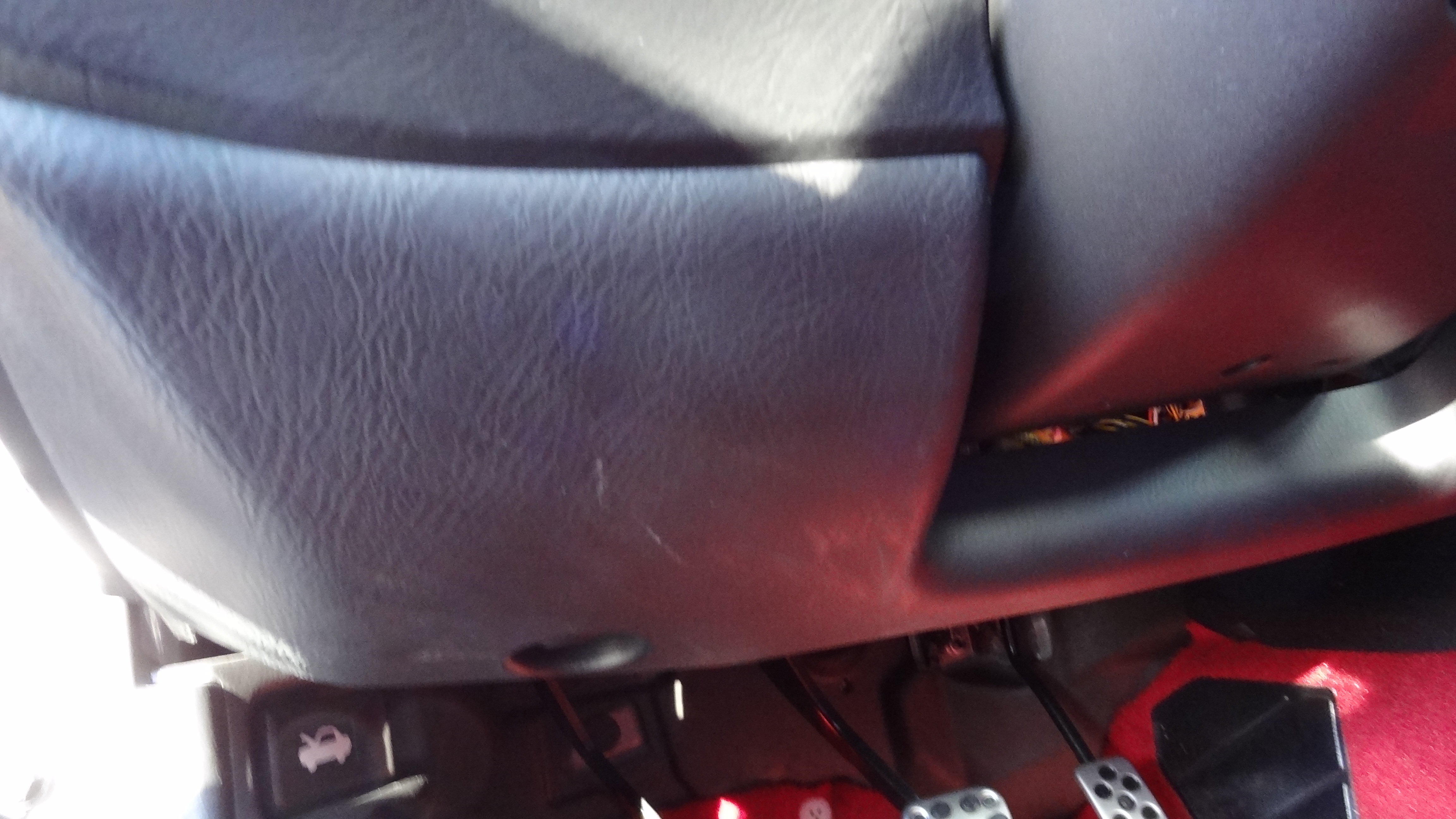

To do so, I think I need the get this panel just below the dash controls off:
Looking for tips/tricks for removing dash & console panels-ysww6fo.jpg

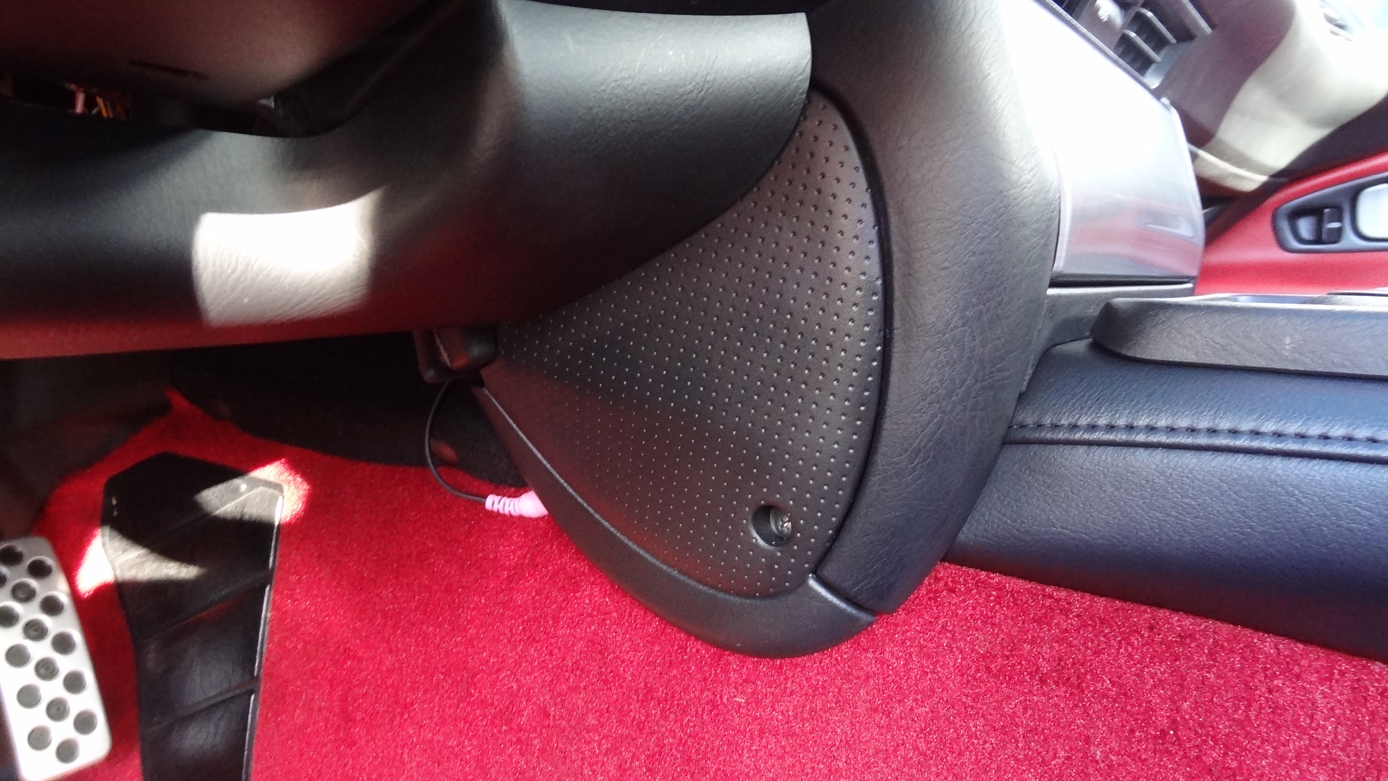

And remove this little side panel forward of the console & below the head unit:
Looking for tips/tricks for removing dash & console panels-p90oclu.jpg
The lower panel has a fastener that you turn like a screw, which I've done. The side panel has a phillips head screw, which I've removed. Still, neither panel wants to budge. Any tips for getting these off without destroying them?

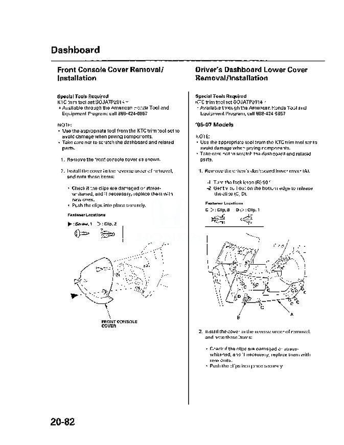

For anybody that's looking for an answer to the question I originally posted here, I found this diagram of the panels in question in an online manual. Useful, at least, for figuring out where the clips are.
Looking for tips/tricks for removing dash & console panels-rjbnn2v.png
