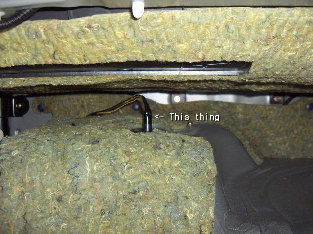

  • There is a sensor there (gas tank?) and I may need to at least bend it over with my install. How much can I abuse this sensor. See image

Sorry that I do not have a photo, but I have a JL Audio 300/4 in there on top of the fuel tank. I have the wire going into the tank bent over all the way, but put rubber stoppers about 1/2 inch high on either side of the wire, so that it would not be compressed by the weight of the amp, and to protect the place where the wire goes down through the metal. The amp is in there tight, and I worried about overheating, but the shop I use has installed this amp in more than one s2000 and has not had overheating problems. You're mileage may vary. Also, watch out for the rubber boot on the fuel filler pipe. All in all, it's a tight fit, but if you can get it secured well, it is the perfect stealth mounting location.

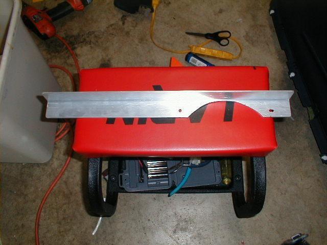

Custom mounting bracket, and amp cover. I made the bracket to use existing screw holes for the bracket around the fuel sensor. No holes drilled in Car.
Custom made bracket. I used 3m vercro to secure the amp to the bracket. Even in Auto-X the amp never moved.

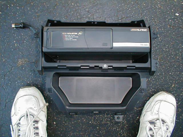

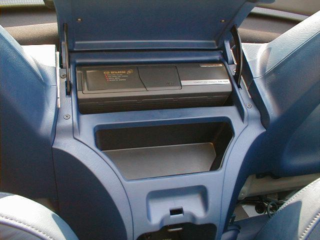

1st ever changer mounted in secret compartment. BTW the changer, pocket, cable and adaptor for the factory radio are now for sale. I have replaced the changer with an Ipod, and Alpine's interface.
changer and pocket

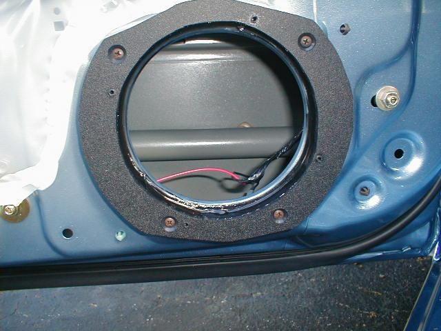

Custom made door speaker spacers, sealed to the door with silicone. This mod enhanced midbass due to less flexing around the speaker (metal flexes, the spacer is 1/2" plastic.
Hope this helps
Wow nice Mitch. Great suggestions on the bracket and velcro and a nice install. I assume you meant that heat was NOT a problem with the amp. Your amp is about twice as long as the class D I am putting in Back to the store for some aluminum angle pieces.
