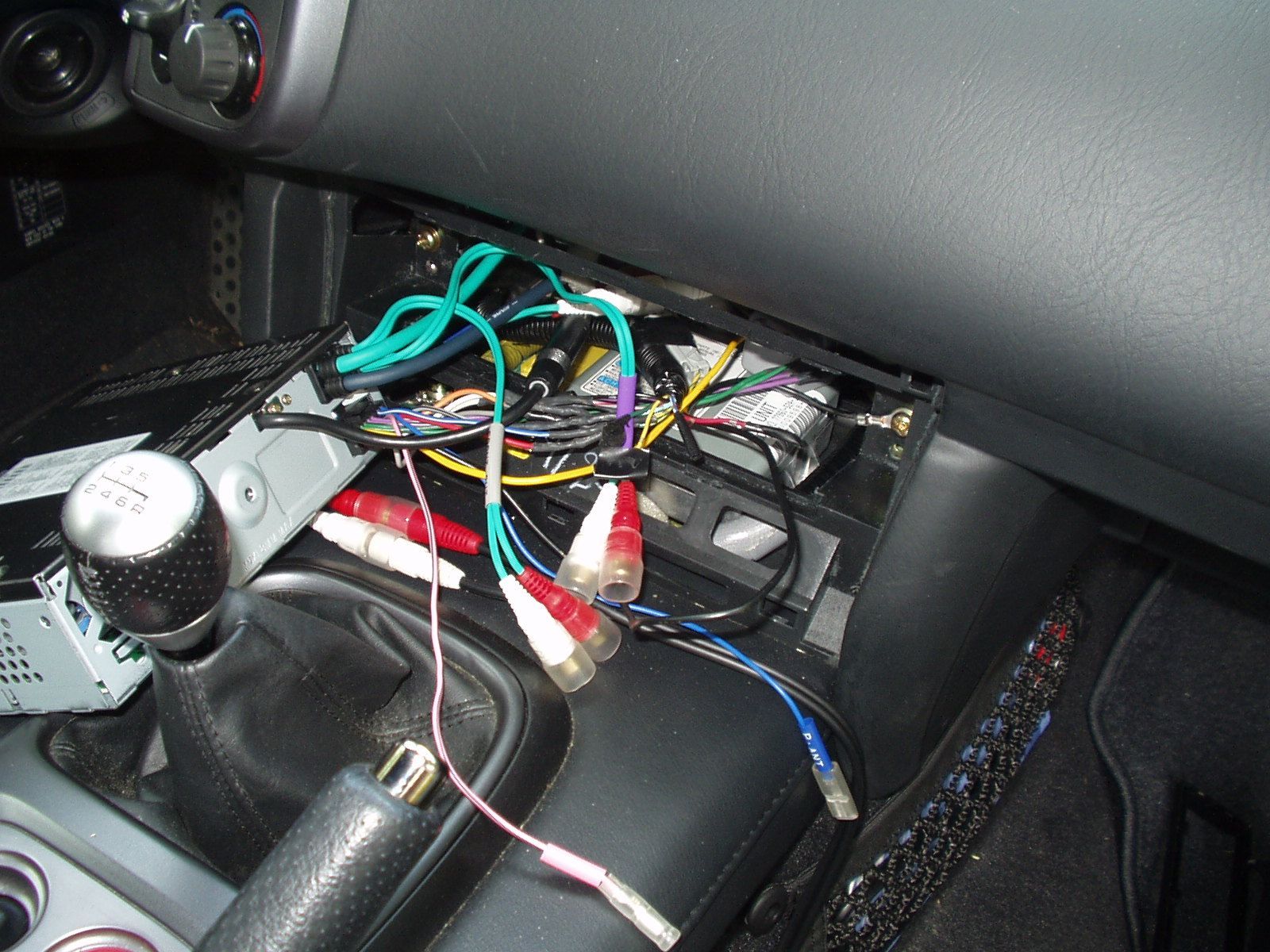

There was a slight problem with the relay for the mute function, one of the leads was in the wrong position in the socket and the correct position didn't have a wire or connector in it. When I hooked it up the muting was reversed, it muted when the LED in the button was not illuminated. I made a jury rig contact with a female spade lug and shoved it in the socket, connected to it, and was on my way.

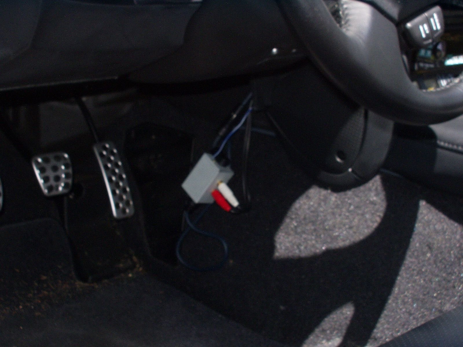

I finally am ready to post some of the pictures of my installation
this is the changer installed under the drivers seat,
The head unit with the soldered wiring.
The switch installation for the AUX/ changer adapter.

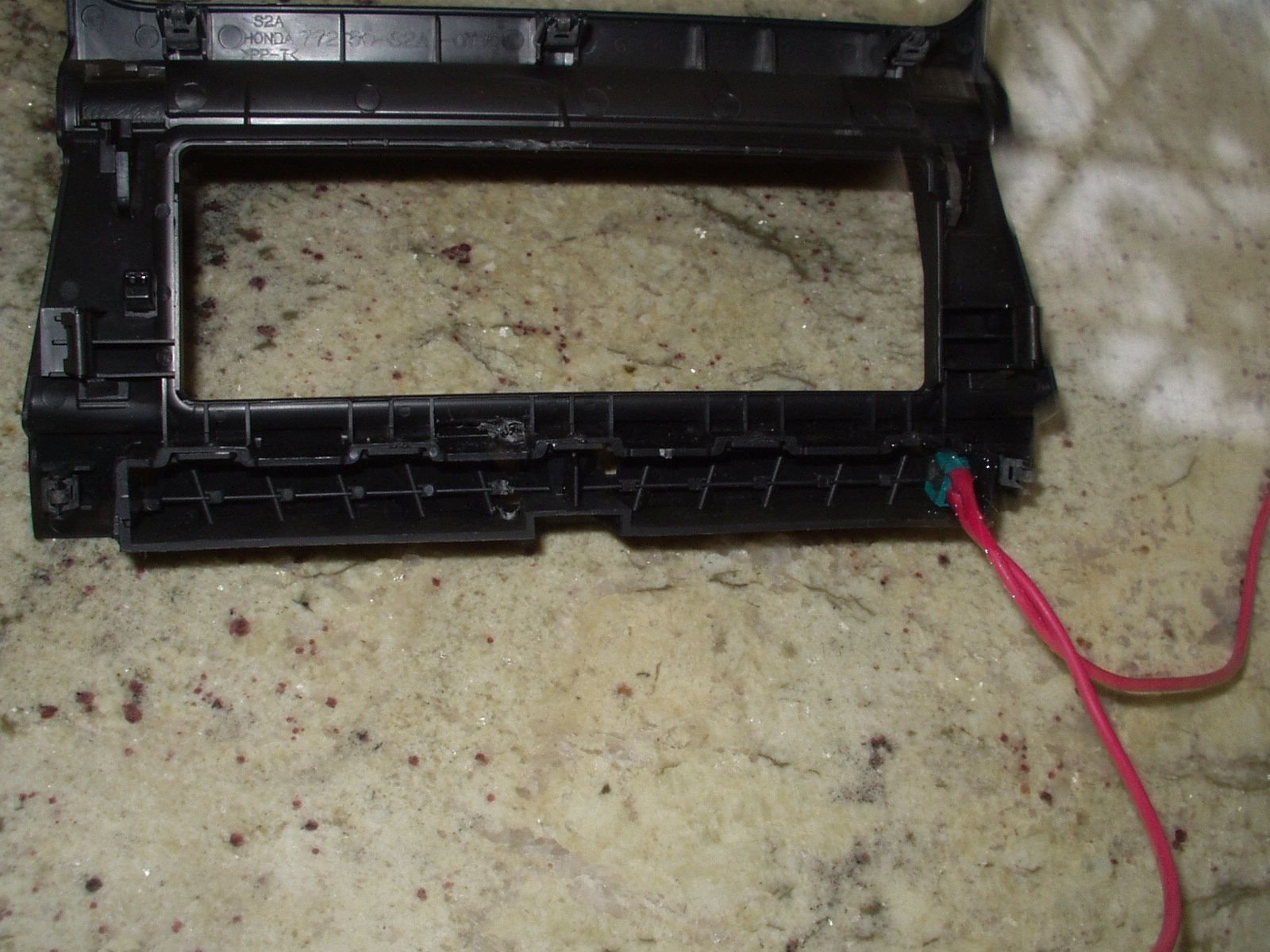

Here are two more pictures of the installation. The adapter before I "tucked" it in place and the radio trim with the switch wiring and the IR emitter leads. I am going to finish this off tomorrow bring out the ignition lead and the amp turn on lead to the area in front of the passenger seat. I have already brought out to here the old 15 Amp radio lead for another use. Supply for the Delphi or another radio.
