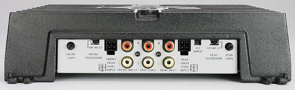

does your amp have a high pass filter on its inputs? You could probably do with cutting off input beneath say 55 to 60 Hz to the front channels reduce distortion for the 6.5" components.

Yup, here you go....I am pretty sure this is your amp, the switch all the way on the left, just to the right of the gain, flick that to HP....that should cure the problem
Here's a picture
