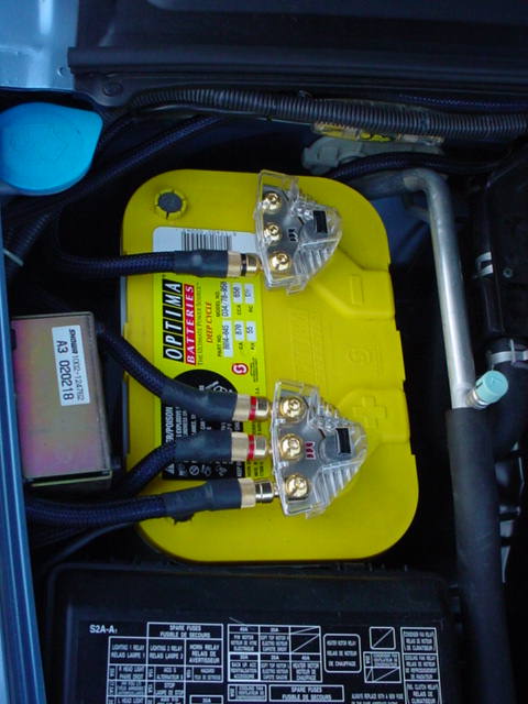

I have Yellow Top (the big one) You need to get a new battery tray kit at the auto parts store.
Then you need to cut it just right so it fits like this:
Once you have it all cut to fit, drill out holes to use the factory mounting bolts as shown above. Its does fit, but its tight:
I purchase a DC battery tie down made for Honda Preludes and flipped it over and it fit perfectly....
