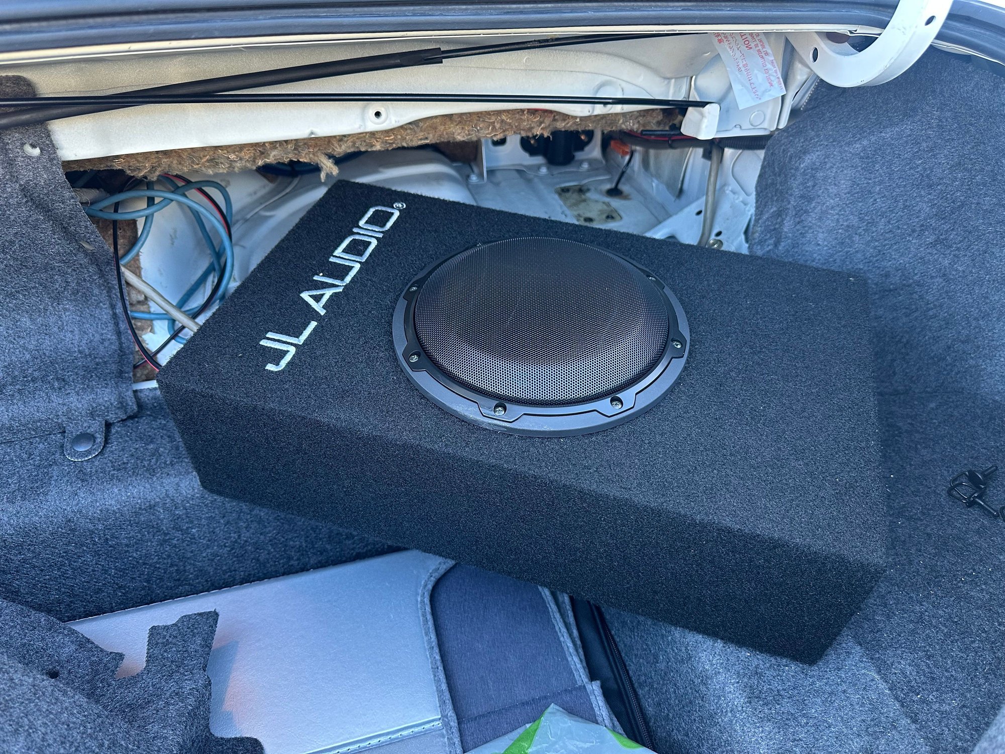

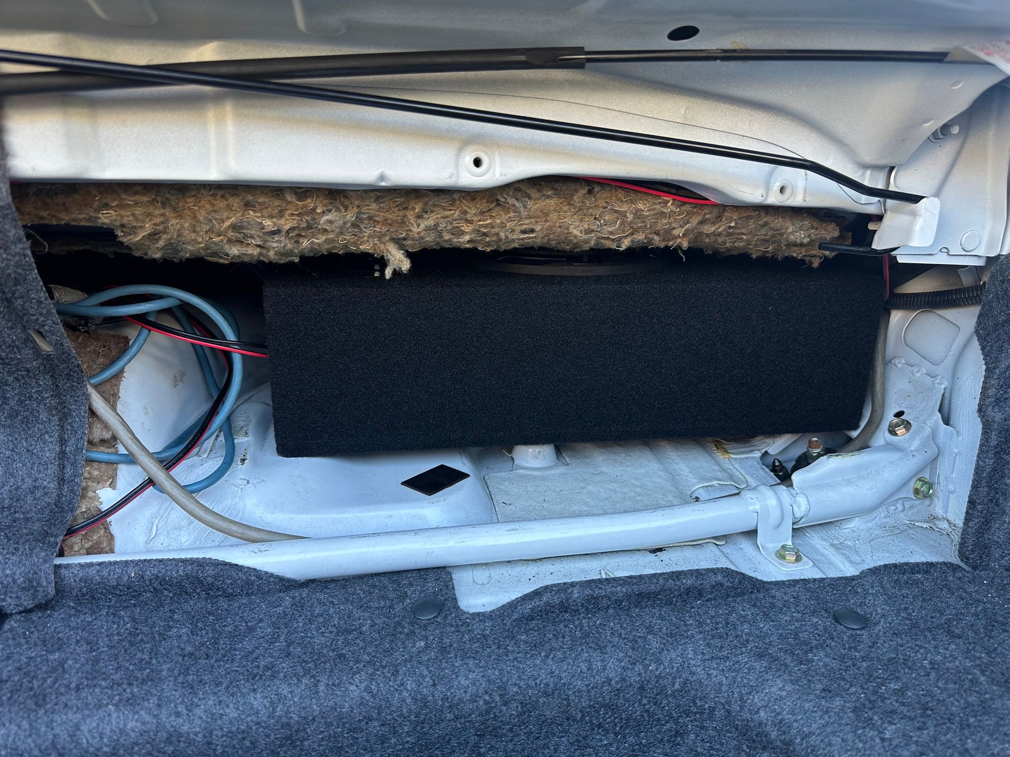

For folks looking for bass options, I took a gamble and bought this JL Audio CP108LG-W3v3, and it fit perfectly in the spare tire space. I didn't want to sacrifice any trunk space otherwise, and I think it probably sounds a bit better being closer to the passenger area. I paired it with a JL Audio JD400/4 amplifier, attaching to the Power Acoustik head unit. Sounds great! I bought my car already with an old amplifier fuse setup, so it was all plug and play for me. But if you don't have any power line running from the battery, then you'll need to wire that.
