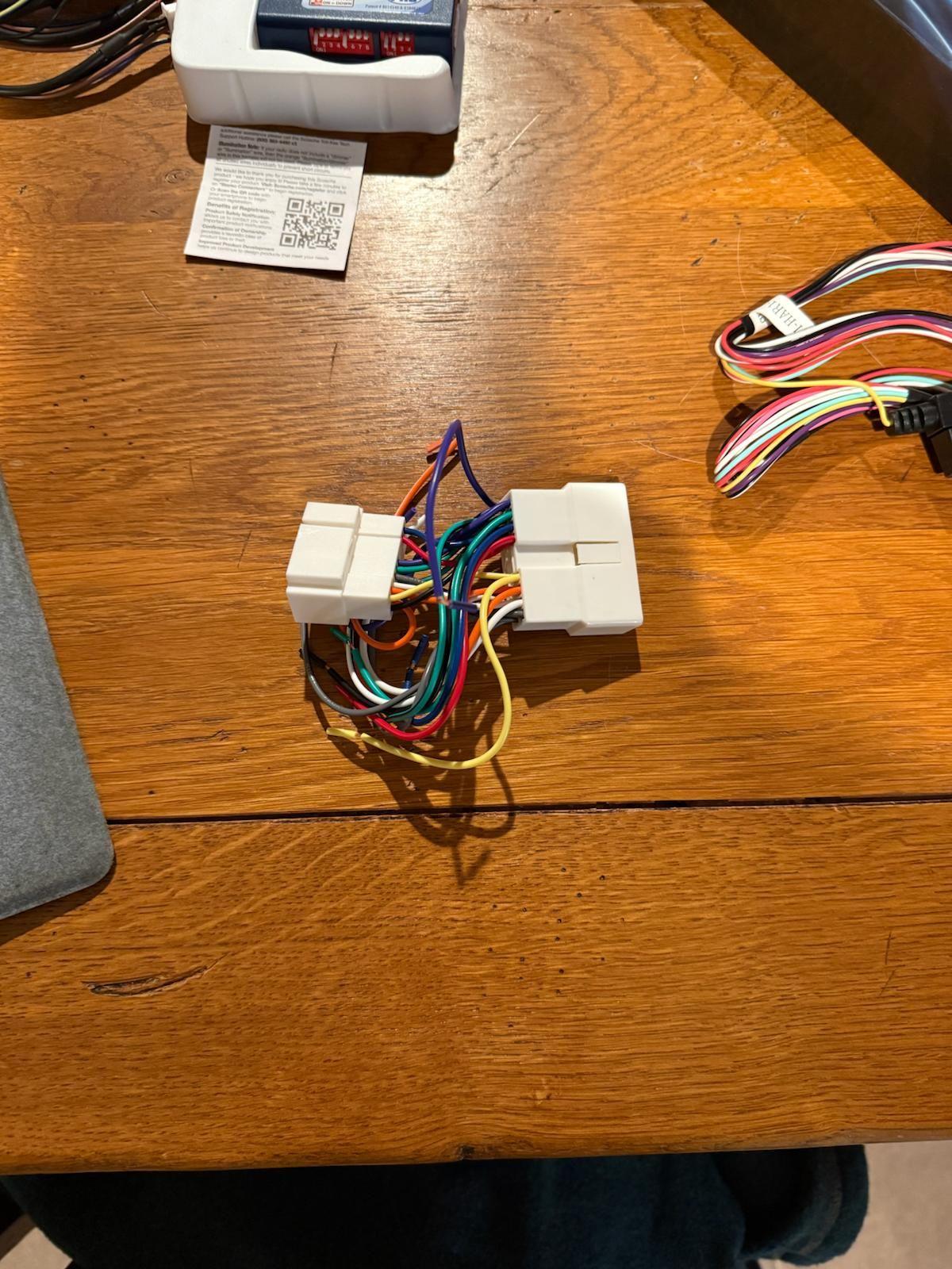

Originally Posted by se-riously
Scosche HA08B harness
I was 100% sure I bought the right thing until I opened it up. This is what I have:
The harnesses have a plug on each end. The one you use in the DIY is a pigtail with only one connector. I can cut off the end I don’t need, but was unsure if that harness saves a step. Any tips or ideas on how to proceed? Is it as simple as cutting the right half off?
In your post, you mentioned steering wheel controls. Is the harness alteration just the two extra wires to make the steering controls function fully, or would there me more steps for a 2007 S2K?
Thanks!
Thanks!
I have no idea what harness you bought, so you should just return it. The one to buy should look like this: https://www.scosche.com/98-honda-accord-harness
Yes, the harness alteration is just relocating two unused wires to allow a connection to the SWI-RC-1. In other words, the signals go like this:
dash switches --> 2 wires --> SWI-RC-1 --> Power Acoustik.
Sorry, my bad. I definitely wasn't clear. I was 100% sure I had bought that exact Schosche harness. Walmart had it listed as a bundle with the head unit. The name was "Scosche HA028-WM1SD Wire Harness Compatible w/ Select 1986-2011 Non-Amplified Honda, Acura & Isuzu" but the part number was HA-08B, as it should be.

oth's Avatar
oth
Joined: Sep 2004
Posts: 1,574
Likes: 62
From: NJ USA
It looks like Scosche made a harness with two connectors, one for 80's/90's Hondas, and one for 90's/00's cars so that people wouldn't buy the wrong one. Just plug in the connector that fits, and leave the other one hanging unconnected.
