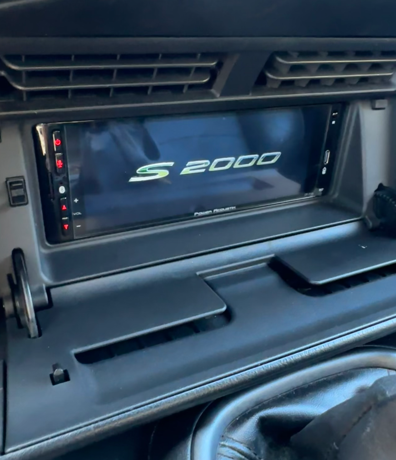

Hi! I shared this a while ago, now updating that I have a different S2000, and the latest SKU for this head unit is Power Acoustik CP-71WA. Works even better: NO DROPS on wireless carplay. I also added a rockford fosgate PS8" powered sub in the spare tire area (just adds a subtle bass to complement the whole system) and sounds and fits great.
Also updated the startup logo:

I like that startup logo.

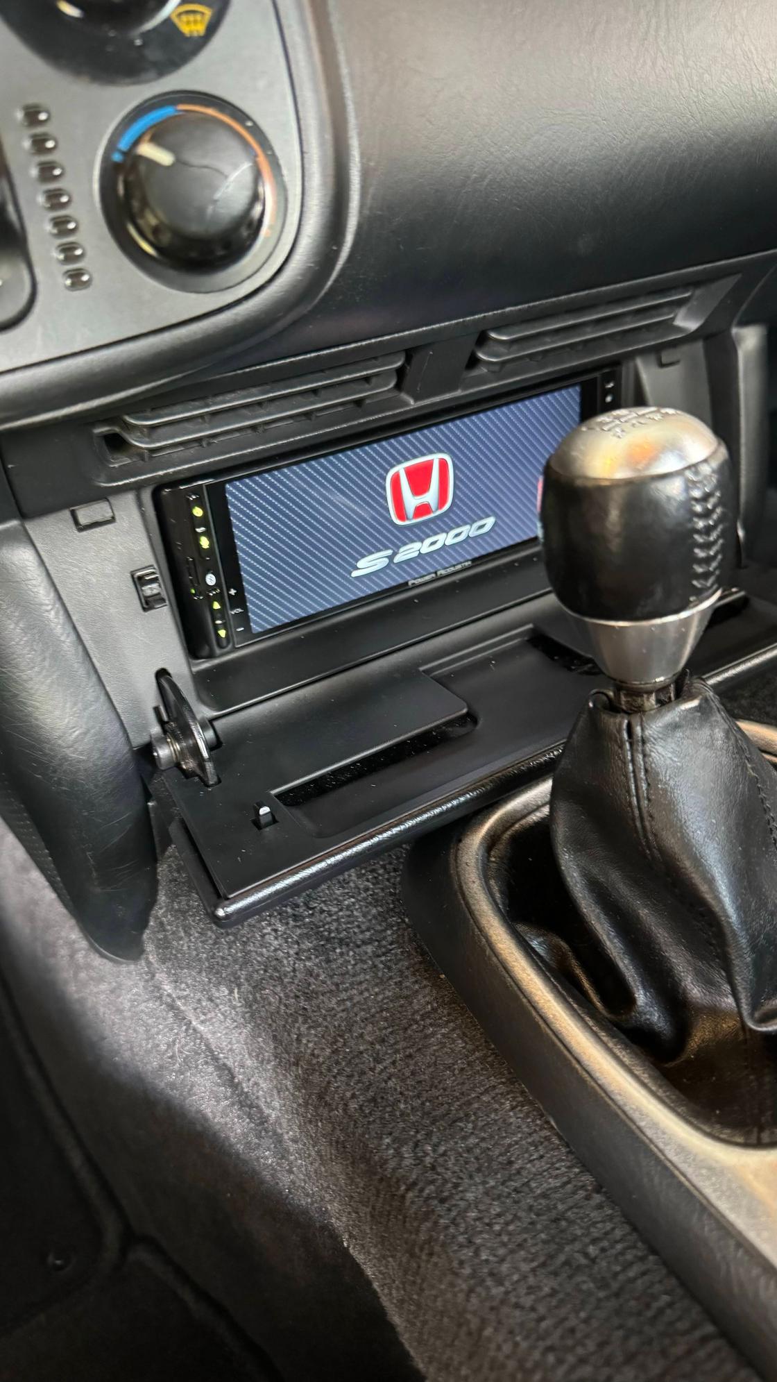

Just wanted to give back to the S2K community with a summary on how to add a Power Acoustik CP-71WA, Scosche HA08B harness ($7.50), external microphone ($5), and fully functional steering wheel controls including MUTE via a PAC SWI-RC-1 ($45 - $50). This is cheaper than using a Modifry harness ($25) and DCI ($90), but requires soldering. DO NOT use the Axxess ASWC-1 ($68) that you see in some YouTube videos because it costs more and the MUTE button won't work. Note that the CP-71WA is the same as the CP-71W. The only difference is that the WA has the latest firmware with wireless Android Auto, which you can download from Power Acoustik and update the firmware of the W version.
4/24/26 UPDATE: There is a new CP-71WAK. Functionally it's the same as the CP-71WA and CP-71W, except the "WAK" version includes a knob for volume control. Bracket instructions updated below to account for the volume knob sticking out from the face.
First step is to modify the Scosche harness that doesn't have steering wheel control wires. Since most 2000-2005 S2K's don't have rear speakers (unless you have a dealer accessory headrest speakers), you can relocate the purple and purple/black wires to the slots shown below. If you have a 2006+ S2000, you'll need a second Scosche harness to "donate" two wires/pins for the steering wheel control wires or you can use Posi-Taps to tap into the factory wires (I don't like tapping into factory wiring though).
To relocate the wires, I used a jewelers screwdriver and stabbed it into the harness until the wire and pin come loose and you can pull it out and then reinsert into the correct pin holes.
Here's the completed harness.
For the PAC SWI-RC-1, be sure to use the Kenwood settings shown below because the Power Acoustik settings DO NOT WORK.
The SWI-RC-1 comes with 2 harnesses, but you'll only solder 4 wires (red, black, white, and purple) on the harness shown below.
Solder or crimp (solder recommended) the wires as shown in the 2 photos below.
And you're done with the harness! Here's how everything will be wired up!
One tip regarding the mounting brackets from the OEM stereo to the Power Acoustik. Transfer the bracket and one screw from each side to the CP-71A or CP-71WA as shown, which will lineup the face perfectly. I did not use 2 screws on each side. I also did not use the metal sleeve that comes with the CP-71WA. 4/24/26 UDPATE: For the CP-71WAK, you'll be using a different screw hole because the volume knob sticks out a bit and can interfere with the radio cover door.
THE FINAL RESULT
