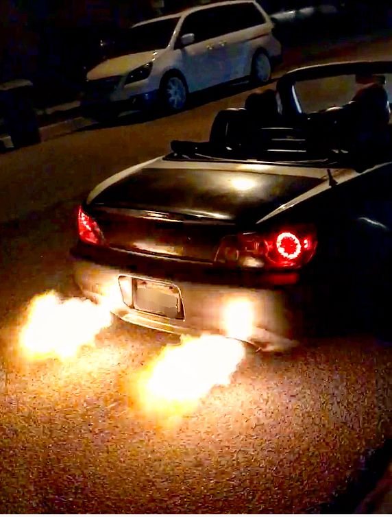

Just an update on an old ass post;
went with AEM standalone, tuned at church auto for $570 w install given hks and my intake peak was a bit lower than I'd hoped but still came out at 240ho to the wheels. Tuner claims if I ditch the hks and get a cold air he can easily squeeze another 20 out of it
Vtec lowered to 3500 and redline raised to 8600 and 2step set at 4800 ignition cut (the fireballs are pretty awesome)
the low end increase is the really impressive part vtec being always available with the press of the throttle is amazing I gotta say.
overall I spent about $1370 and it was well worth the money. If you're considering a piggyback just saved the extra cash for a standalone you won't regret it
