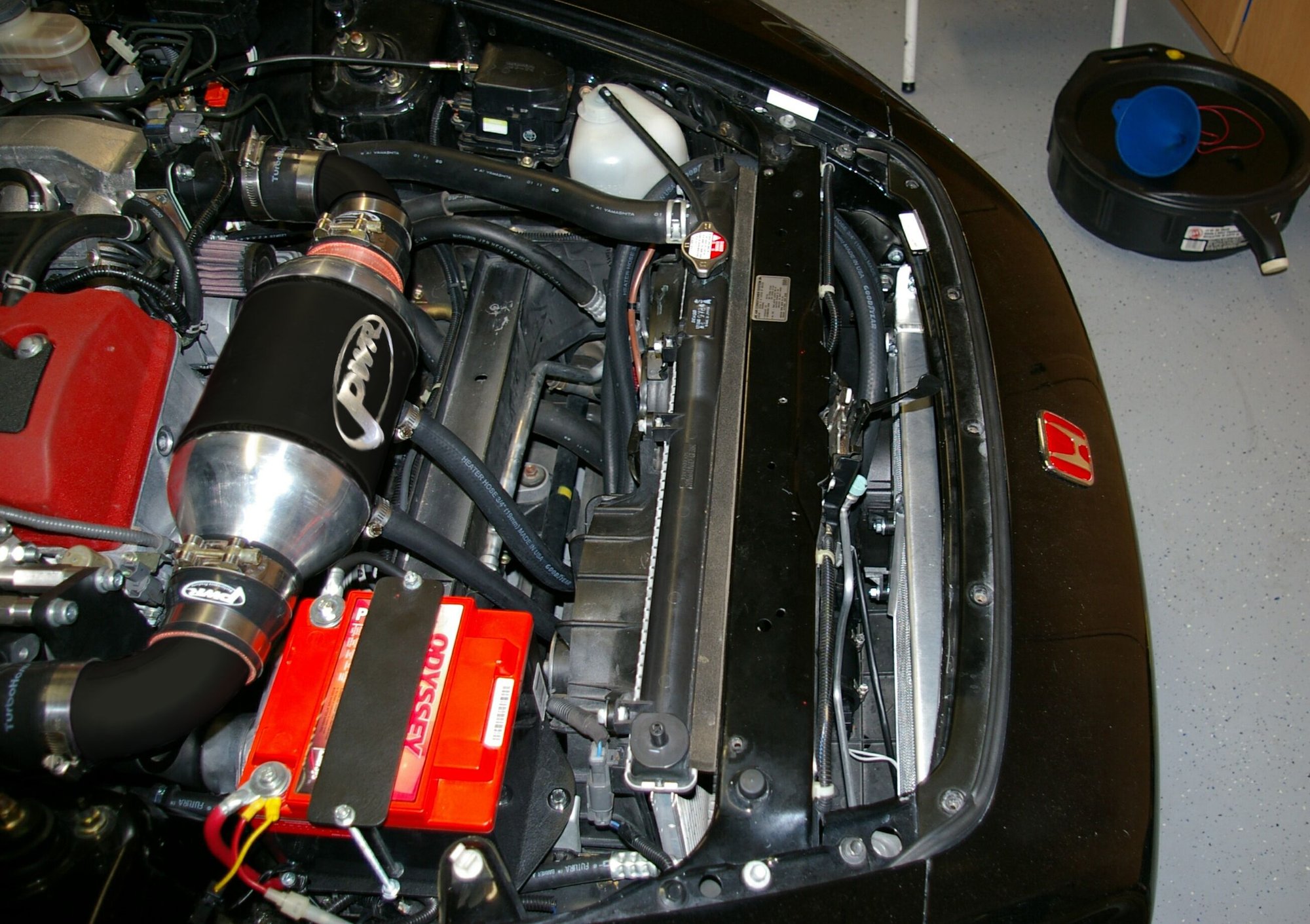

You are probably right about the red.
The barrel has a PWR logo but it is oriented so the hose nipples would be pointing straight up - which would require some holes in the hood and it would look a little tacky with the hoses running outside the car .
They can change the orientation, and I am also looking into having a fill port put right on the top of the barrel.
photochop black center panel w/ polished logo
plus the pipes are black now... Click 'em for bigger pics
hey man, I LIKE it

Looks nice - thinking maybe having an SOT logo on the barrel would be better?
