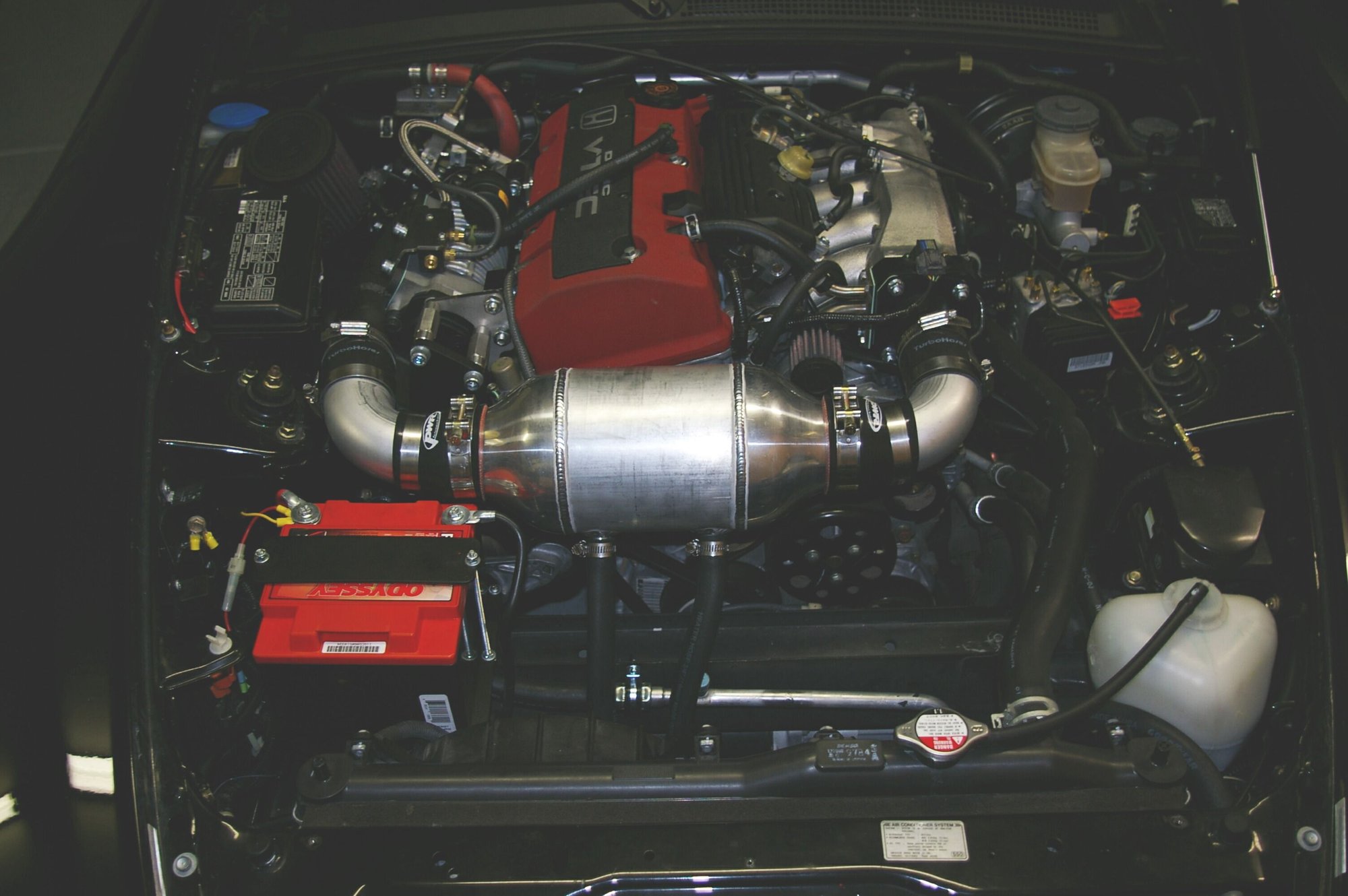

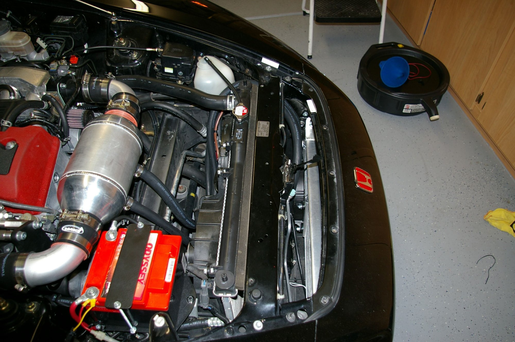

Couple teaser pics:
Wow - my front bumper looks like ass - need a repaint
