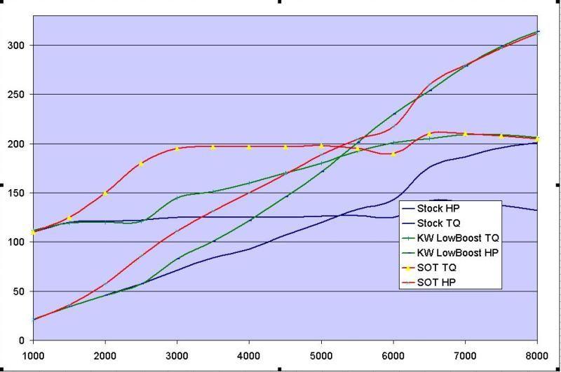

This is a better representation of how someone would apply the throttle.
