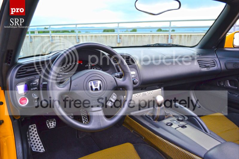

I use the plx dm-6 multi gauge. You have to buy each sensor module separate which comes with the control box and sensor. Then you just link all the sensor modules together using the supplied wiring. The modules arnt very big and pretty easy to hide under the dash. The gauge itself is very slim and I had no trouble retrofitting it above the start button.

I'm running a DM-100 an DM-6 (both flush mounted). The box for the DM-100 is mounted just under the start button behind the dash. I'm running 3 sensors to the DM-6 (so 3 boxes). I mounted them behind the panel where the glovebox would normally be.
