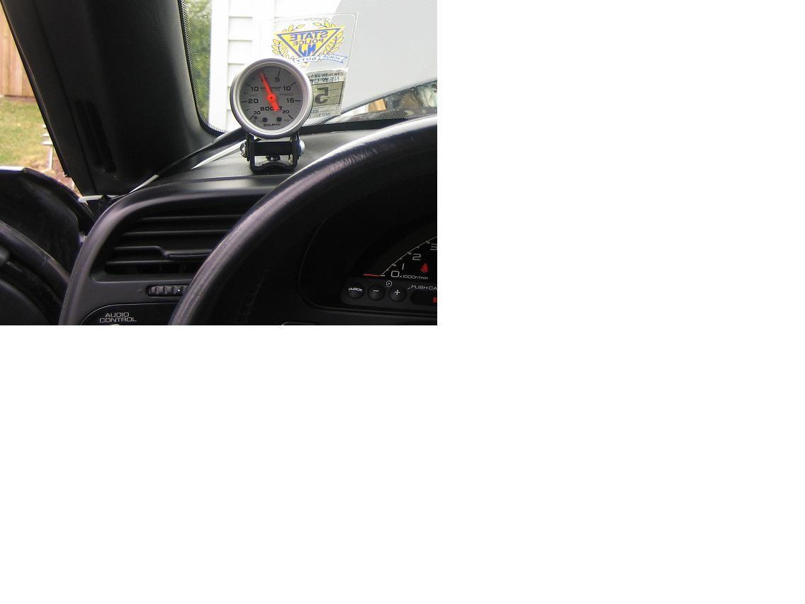

Ok here, some pics of my setup, engine bay is rather dirty
well I have to figure how to upload them

pics
The text is too small, but the one on the left is pointing to the Blue VAC line which is connected to the BOV, the Text on the right, is showing another "T" off where the line to the Gauge is coming/going

is that where you're supposed to tap the BOV and a boost gauge?
I'm ordering the AEM TruBoost today ...
Hope so........... I was told by another member to place the BOV VAC line off the Fuel Pressure regulator hose. The Gauge Vac Line I just placed there as well because it was the closes VAC line to the inside of my car, hopefully all is ok, seems to work fine

Mr.Aqua's Avatar
Joined: Oct 2003
Posts: 1,058
From: San Diego
Thats how I set mine up and no issues so far.
