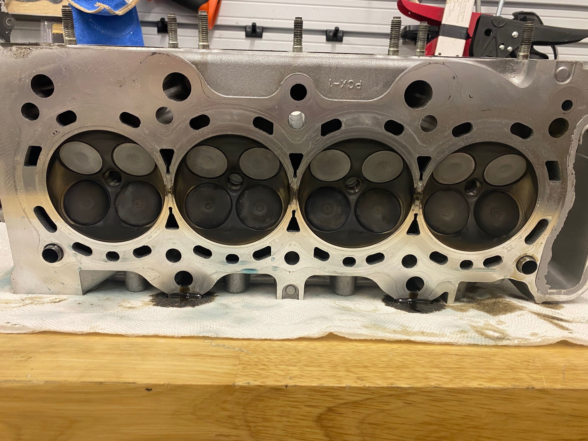

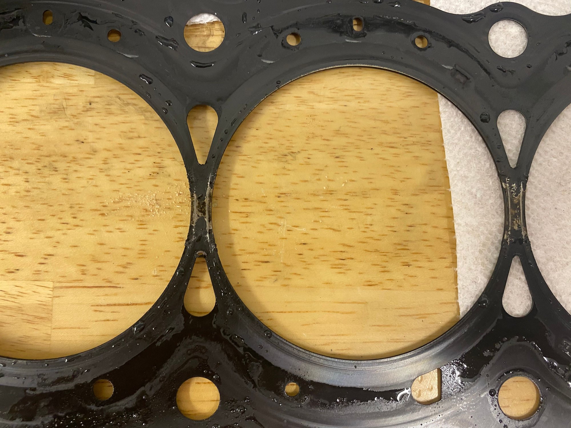

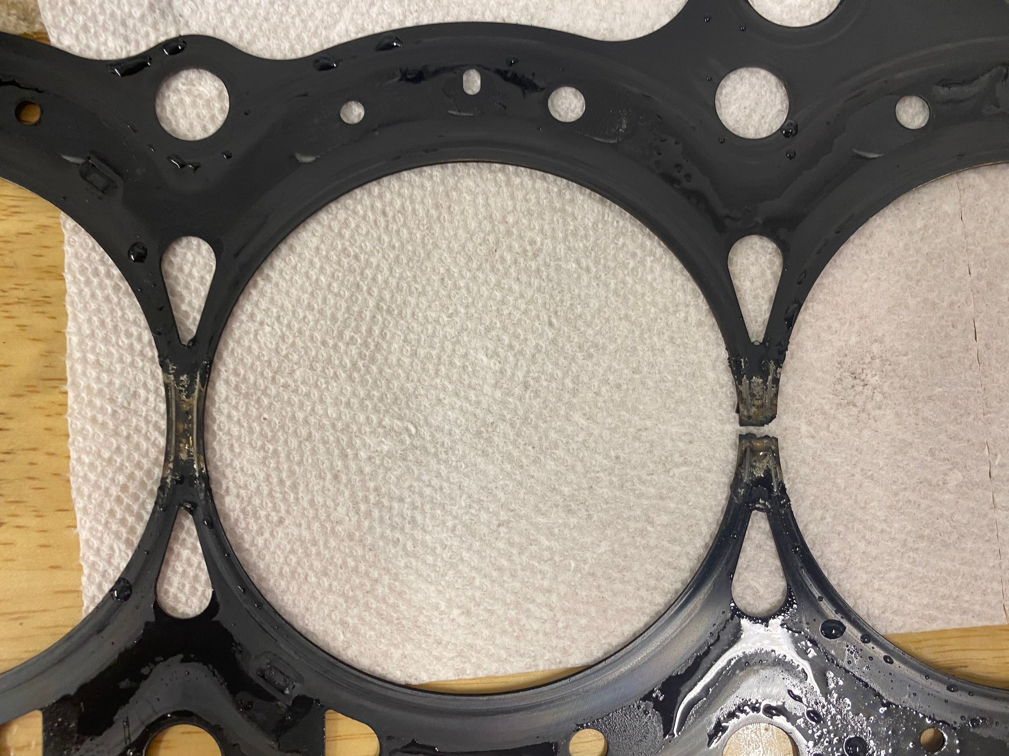

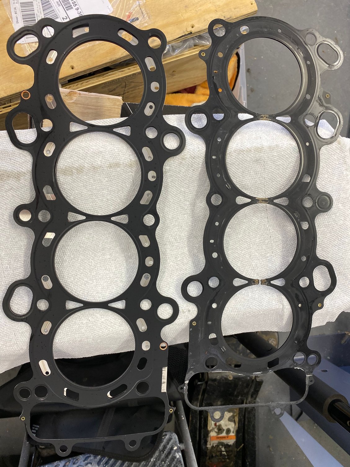

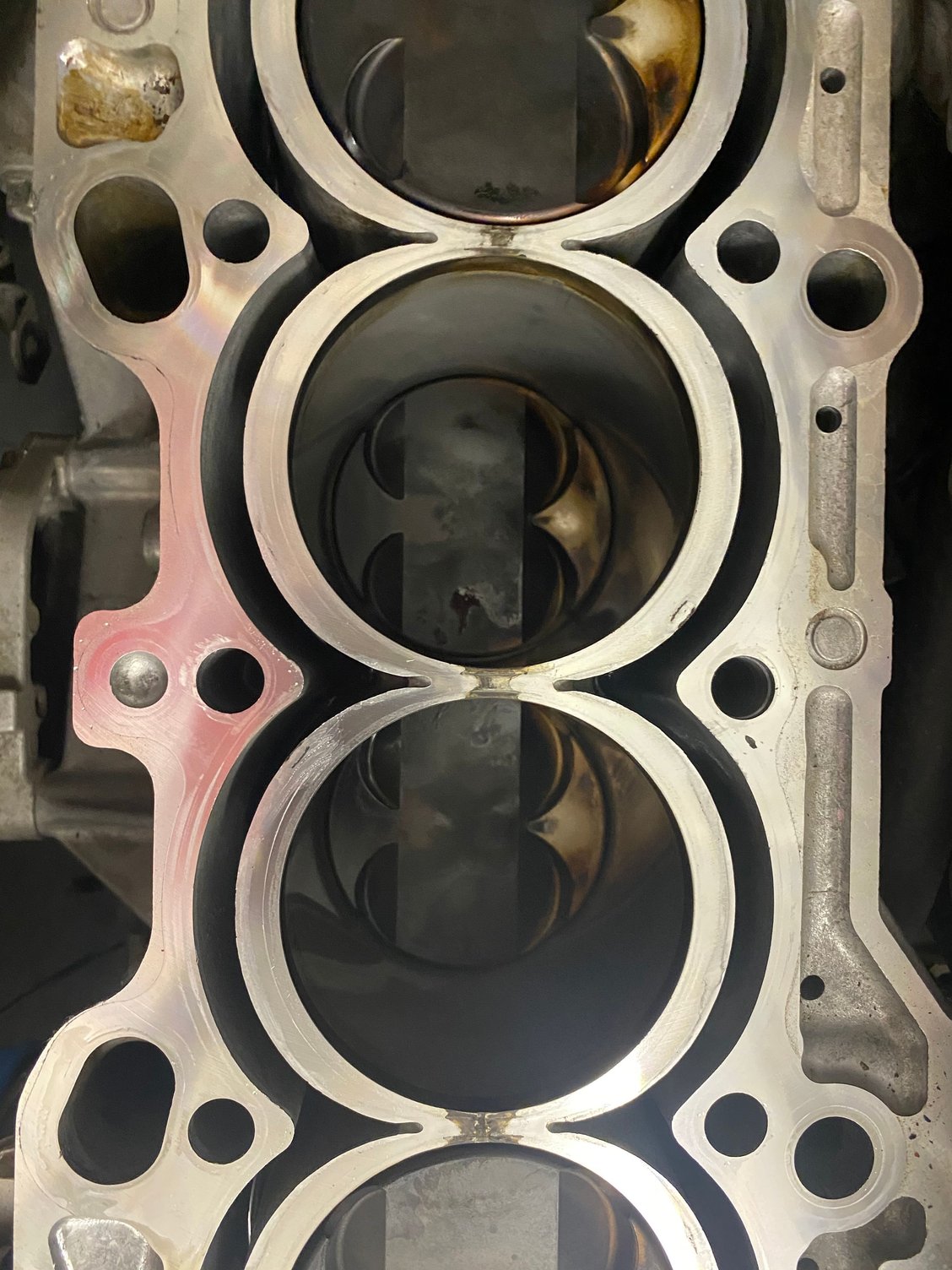

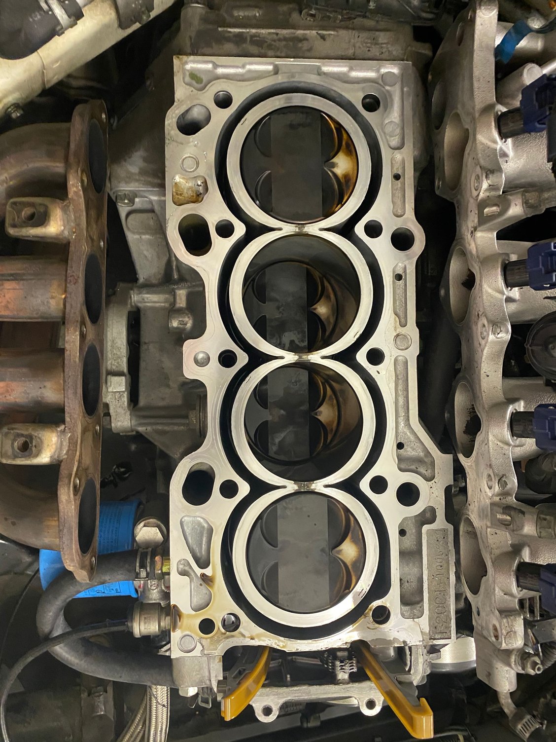

Ok all, the results are in... it was a blown headgasket coupled with an out of spec milled cylinder head.
I replaced the HG and cylinder head with a brand new in box cylinder head this weekend and the car has never ran better. The first start is the first time this car has not had the TCT rattle in 4 years, since I bought it. I took it out for about 15 miles after burping everything, then came back and did a leakdown. Leakdown results were below 9% on all cylinders... the best readings I've ever had from this car.
I did notice that the HG I pulled out and the OEM honda one were different. The one I pulled out was a double layer, Honda is a triple layer.. much more stout feeling than what I removed. Pics below...
