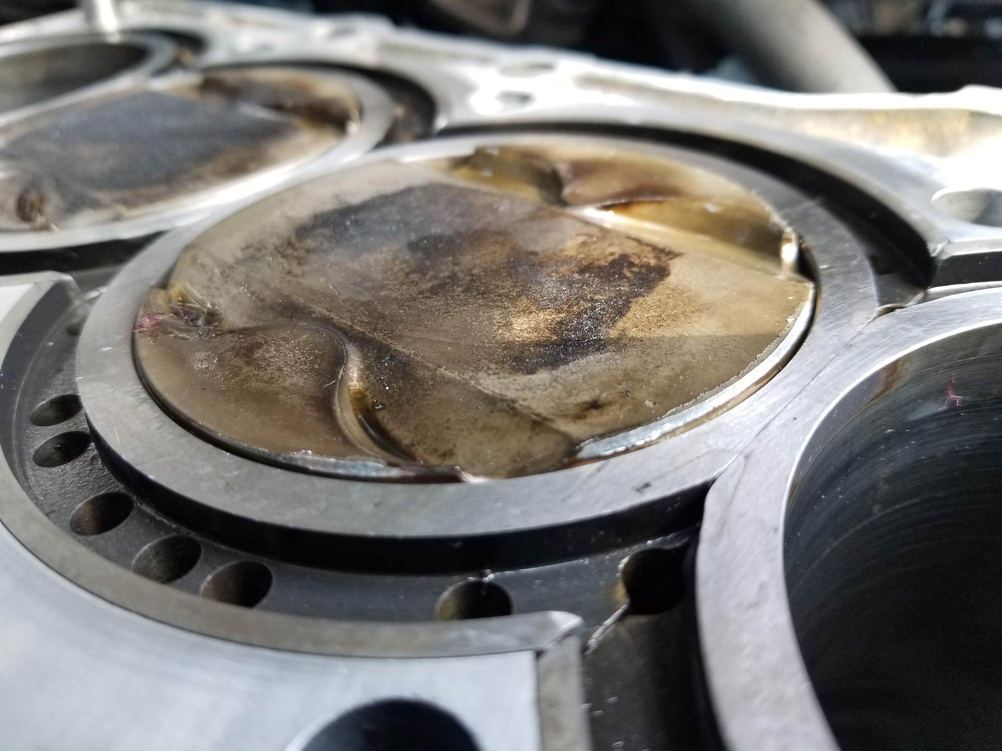

I did a leakdown tonight with the header detached from the head. Obviously motor was ice cold but here are the results:
CYL1: 60% leakdown with air coming from exhaust valve, cyl 2 spark plug hole, cyl 2 exhaust valve
CYL2: 60% leakdown with air coming from exhaust valve and cyl 1 plug hole
CYL 3: 30% leakdown with air coming from exhaust valve and cyl 2 plug hole
CYL4: 15% leakdown with air coming from exhaust valves and cyl 3 plug hole
Interestingly enough, I did have the radiator cap off during the test and didn't have any bubbling or anything of the sort from the cap, although I am running a sideways radiator so it's about triple the capacity of coolant and with so much pressure escaping through the plug holes and exhaust valves, I assume I didn't have enough to bubble the coolant. The car does not use coolant, blow white smoke, anything like that.. BUT I did notice in the week or so leading up to the track day that after running the car hard my radiator hoses seemed pretty pressurized. I attributed that to the up-rated rad cap that came with my sideways radiator.
I've long suspected this head wasn't 100%, but inline pro rebuilt it and said it was good to go on the first engine build I did with them. It was part of their refresh signature series "package".
The previous owner made some posts on s2ki from 10 years ago stating that the car shut off at a redlight, wouldnt idle correctly, etc. He said he took the car to a "shop" where they found some "valves screwed" and fixed it. When I first took this car to inline pro, they found sunken exhaust valves and botched machine work done to the head, so they machined in new valve seats on I believe all the exhaust valves.
Now, I've had the TCT rattle since I bought the car. I've replaced the TCT with a Billman TCT, never fixed it, then Billman sent me a revised TCT, didnt fix it, then Inline pro put in their "race" TCT, still hasn't fixed the rattle. On the 3rd engine build from inline, I requested they replace everything timing related with new OEM parts, which they did... still didn't fix the rattle.
I believe I have a head that's been milled to out of spec. With the previous owner machine work and inline pro milling the head during their rebuild, AND my TCT issue not going away... I highly suspect my head is out of spec, timing off a bit, and obviously now the head is warped/gasket/something.... If this is true, this could be the cause of all of my engine issues right? With timing/compression different than what inline/tuners are expecting, then the cylinders would be heating up beyond expectations causing the pistons to expand and score... right?
