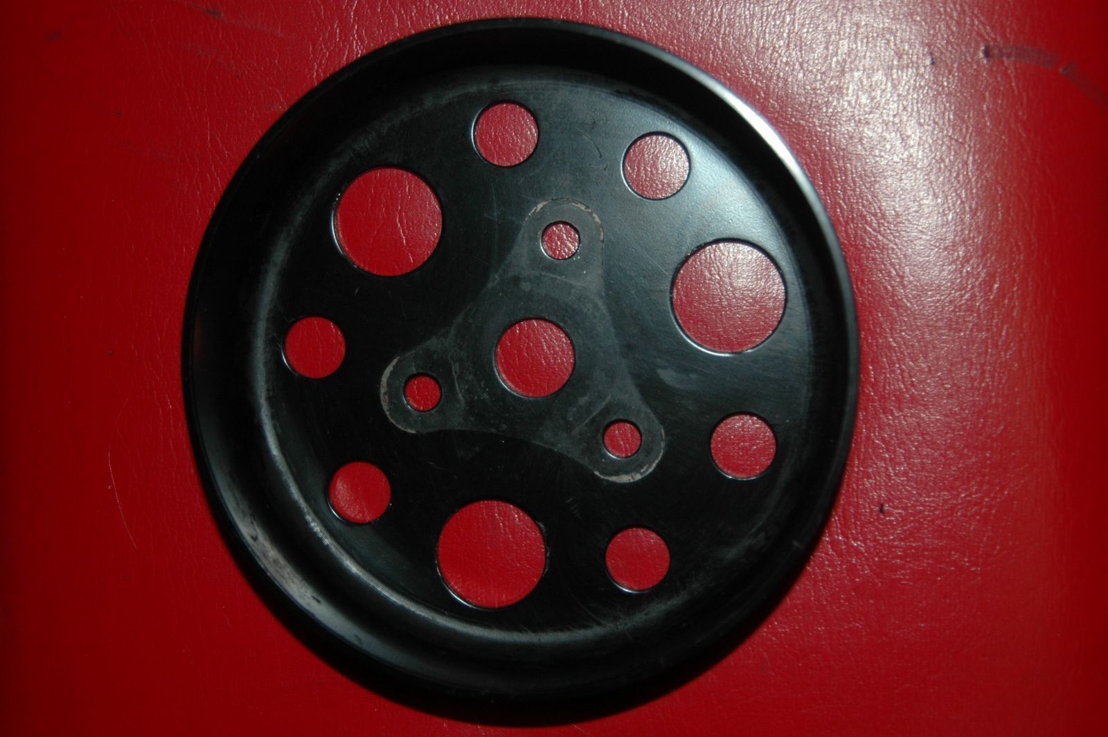

I just finished installing a dual core radiator in my car to complement the longer Mocal oil cooler. I hope to keep the temps down at the track. It's 104 F out there. I'll post some pics of the install in the other KW coolant thread. I also monitor the engine coolant temperature from the OBDII, and am installing an oil temp gauge on the stack.
BTW this is my water pump pulley after almost 50,000 miles -- most of that running the KW High Boost Kit. The pulley has been R and R-ed a couple of times for installations. I don't see any hairline cracks at all, so apparently it is still good to go.
Back side
Hey Jim! I hope your waterpump pulley survives without incident. Mine lasted till I had 83,000 miles on the car, 60,000 miles after installing the KW kit. I watched it closely after the first failure was posted and I caught it while still in the hairline crack stage.
