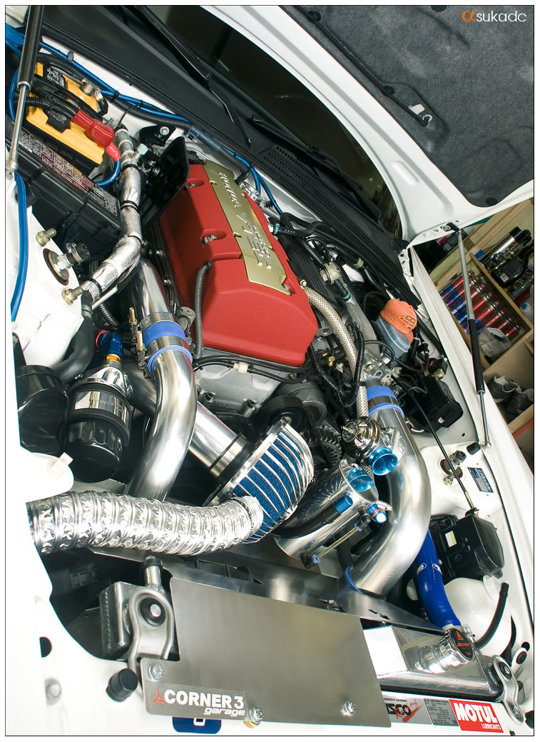

updated by pic, with both catch can.. probably wont do anything extreme til the new kit comes out..
i have one of the early reloc kits, i'm not using a honda oil filter... it fits toyota filter/ nissan 300z filter, rofl.

oh, but i do want an oil cooler on this thing.. any input from u chris?
i think tommy was using the greddy oil cooler with the kit, he just put the sandwich adapter on top of the adapter that comes with the kit. I'm not 100% sure that's how he did it, but thats what i thought i remember.
you could also buy a special adapter with 4 fittings, this is what Trust did on their prototype for the ap1 (oil filter sits on the adapter, 2 lines go to the block, 2 go to the oil cooler). Greddy actually sells the 4 fitting adapter, it's kinda expensive, but it's a nice piece if you want to do it clean.
i'll try to dig up some pics of Trust's oil cooler setup with the turbo kit. it's pretty nice looking.
