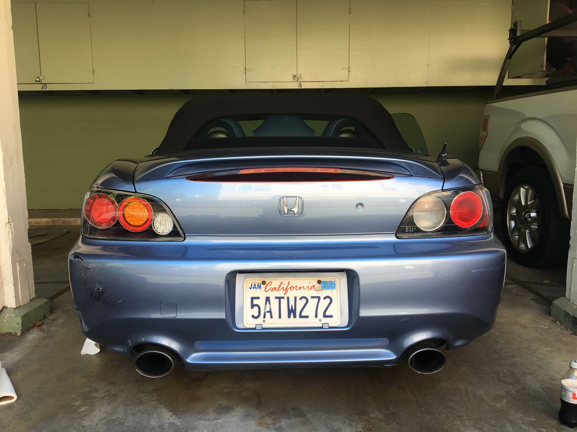

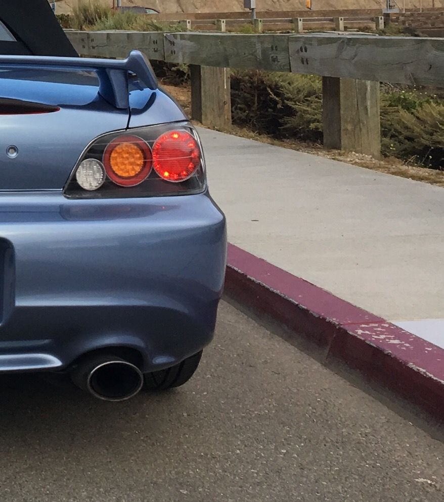

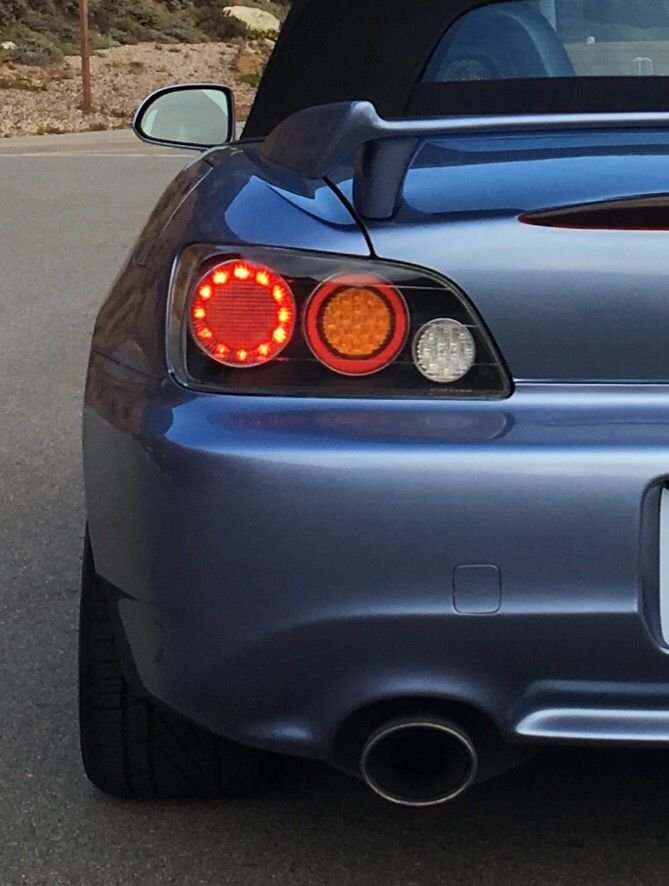

Test fitment before going to bodyshop for bumper fix. Did the cable swap as suggested and they are working. They are SOOOOOO bright!! See the attached video
