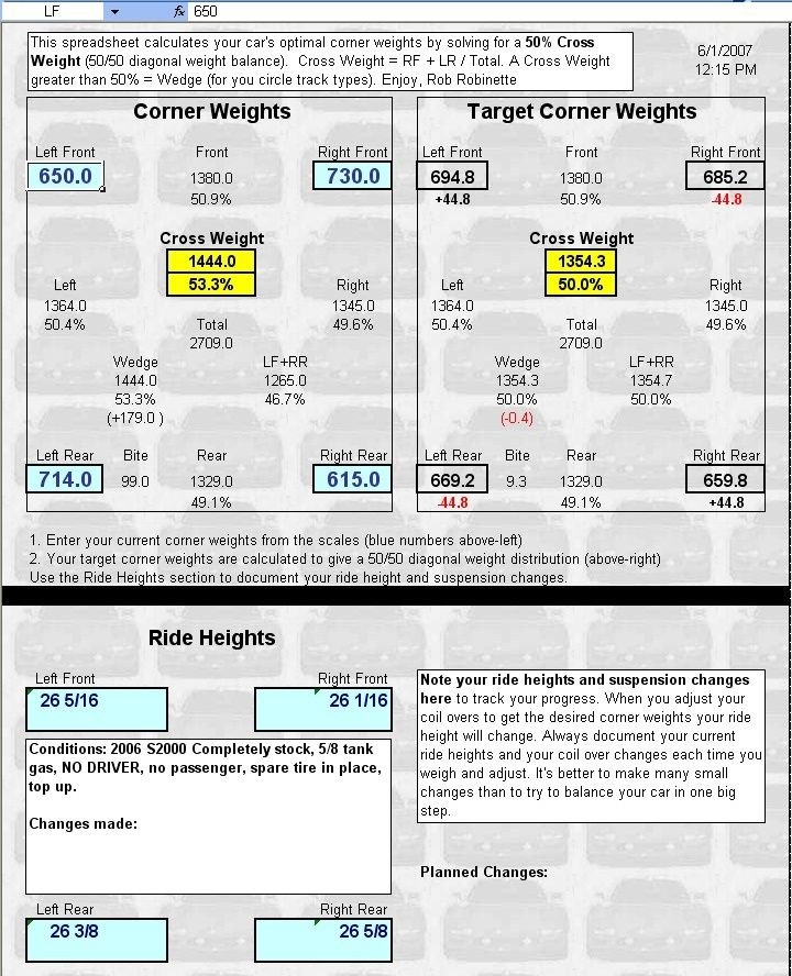

Check out Rob's website on how he corner balance his S2k:
http://www.robrobinette.com/corner_weight.htm
Stock S2k cross weight is such that left front < right front, right rear < left rear so the car has slightly more grip in left turn than right turn.
So we should expect to raise the perch on rear right and left front to balance it.
Keep in mind that the corner weight for each car is different, mostly depending on the ride height at each corner in relation to each other.
