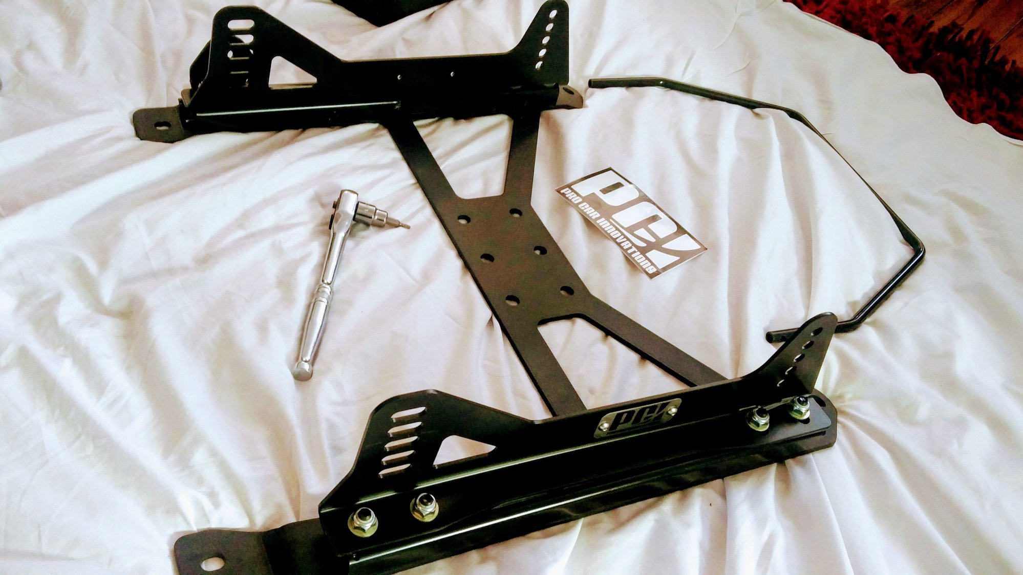

4 months ago I bought the PCI mounts made for and came with their sliding rails. Bucket seat I am using is a Cobra Imola Pro seat on a RHD UK car. Seat can go very low, especially at the rear of the seat as I prefer a one hole tilt back fron front to rear. The bottom of the bucket seat at the back is almost touching the floor and is perfect. On a right hand drive car the handle for the sliding rail will have to bent upwards slightly before fitting, to slide over the big hump in the floor pan near the transmission tunnel. This is on the RHD side of the car. The only issue I found was that the mount, back hole near door side, was a couple of mm out of line with my car's bolt hole. The mount needed a tiny bit of drilling out of this hole to line up properly with floor bolt hole. Otherwise it is a superb bit of kit, very impressed with the build quality, so much so that I imported it all the way over to the UK. There was nothing available off the shelf as good. Buddy Club and M2 seat rails welds and flimsy side mount brackets were not upto track use IMO and were returned by me. It cost me over £275 UK pounds including shipping and tax but still worth it. There is also a few cm adjustment available to position the seat left or right i. e. near transmission tunnel or door. All in all a great purchase from FR Sport.

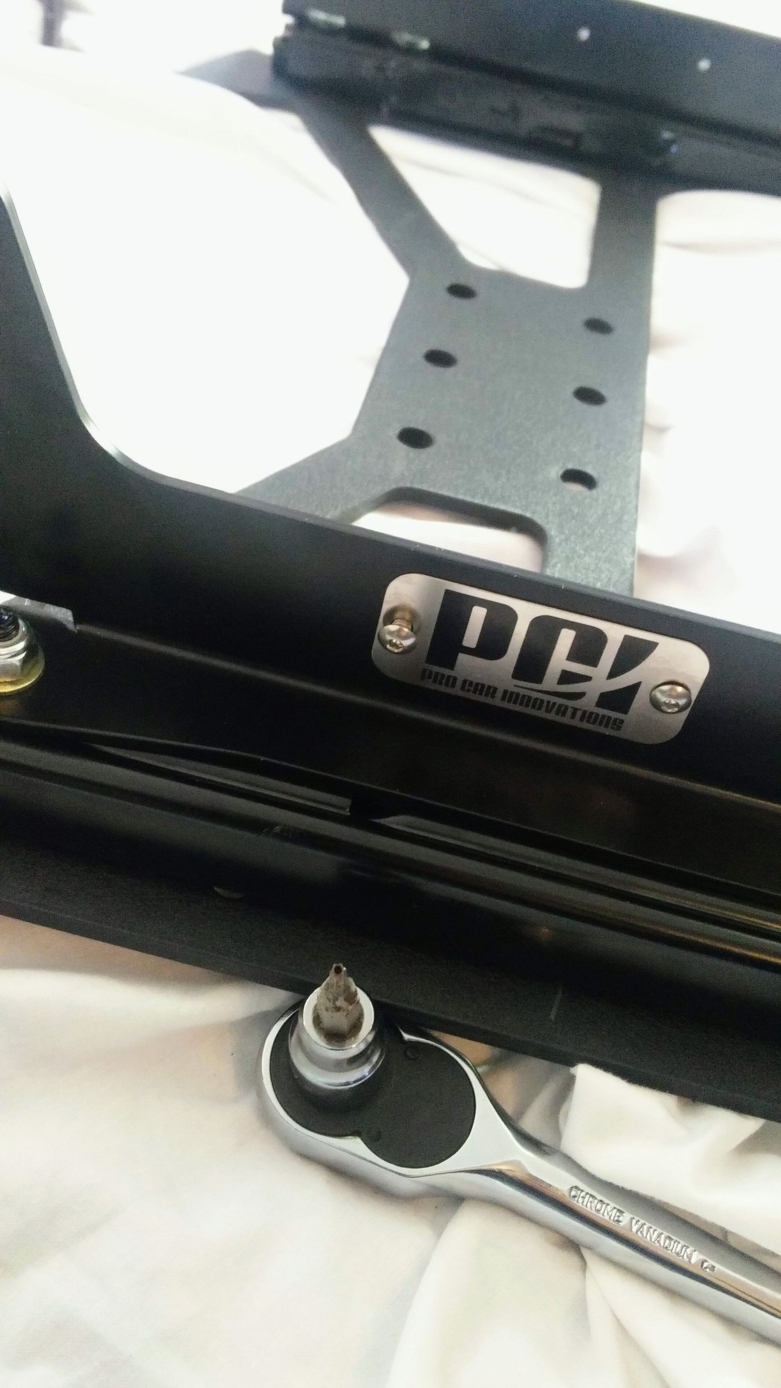

Anyone who has installed the PCI Adjustable base/bracket, did you have to replace the rear inner base mounting bolt, if so what did you use? Mine hits the seat bracket and i cannot move the seat back to a comfortable distance. I really need like a 1/2".

I'm using a button head allen bolt in the front where I had clearance issues.

Before someone points it out, I just realized why they send a little baggy with 2 bolts, One is a replacement for the exact bolt I'm having and issue with .
