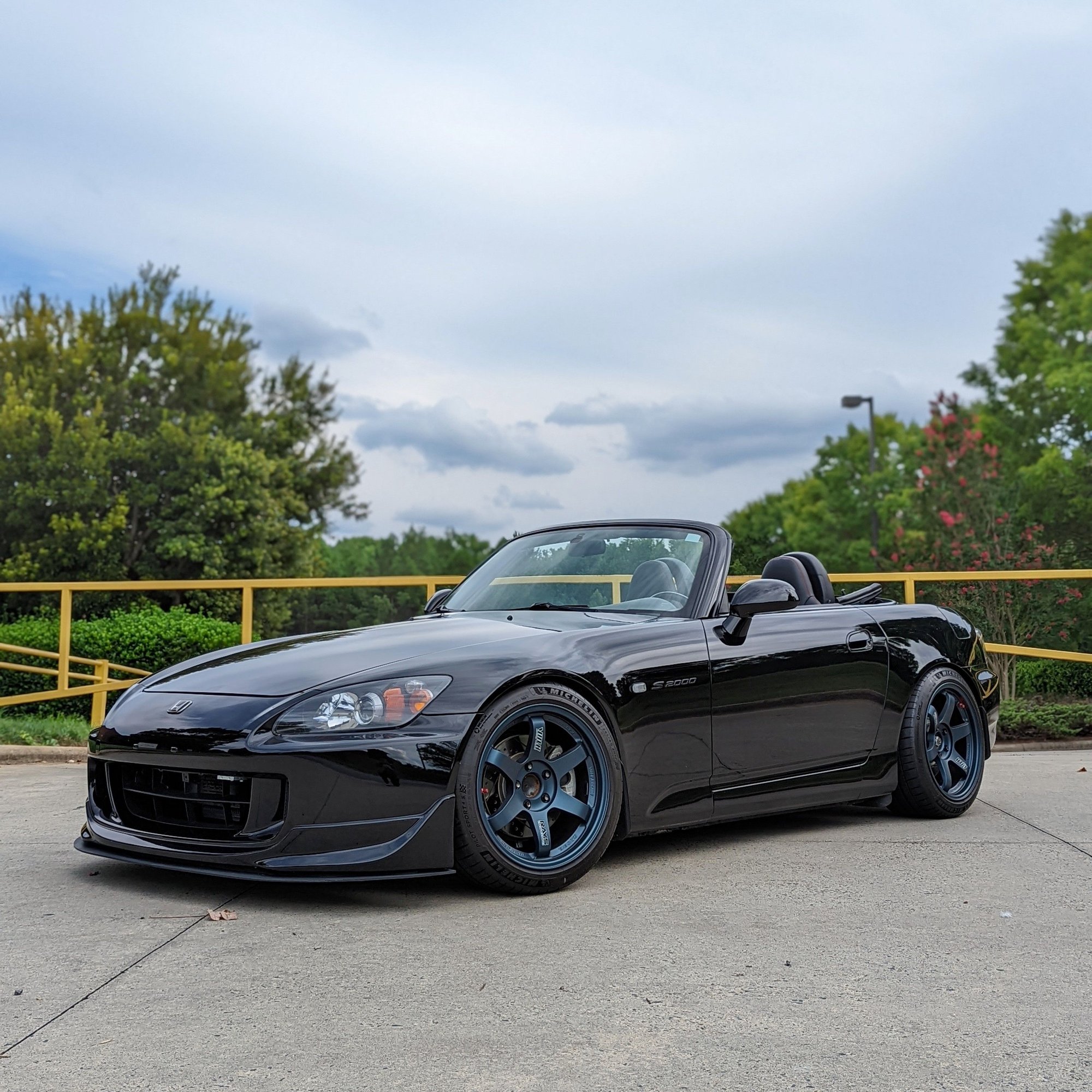

I also never shared the new AP2 I picked up in February. Its odd how the "same car" drives and feels so different..
I did a couple things to it right when I bought it.
Had it retuned on a dyno with hondata, picked up another 10-15whp vs the old gernby tune that was on it.
Adjusted the Ohlin DFVs and had it aligned twice, then installed the new TE37SLs in matte blue gunmetal. Running -3.2 Front / -3.0 Rear with 245/17 PS4S tires.
Of course I changed every fluid along with other miscellaneous things and then sold off the Spoon calipers.

What spring rates did you go with on the 2WNRs? I'm loving my 2WNRs - i've been super happy with them. I'm running 750F/700R with a CR front sway and stock 06 rear sway.

800lb front and 700lb rear with karcepts F/R bars.
I'm ready to get back out there. After driving an AP2 with MCS that weren't even that dialed I was thoroughly impressed.

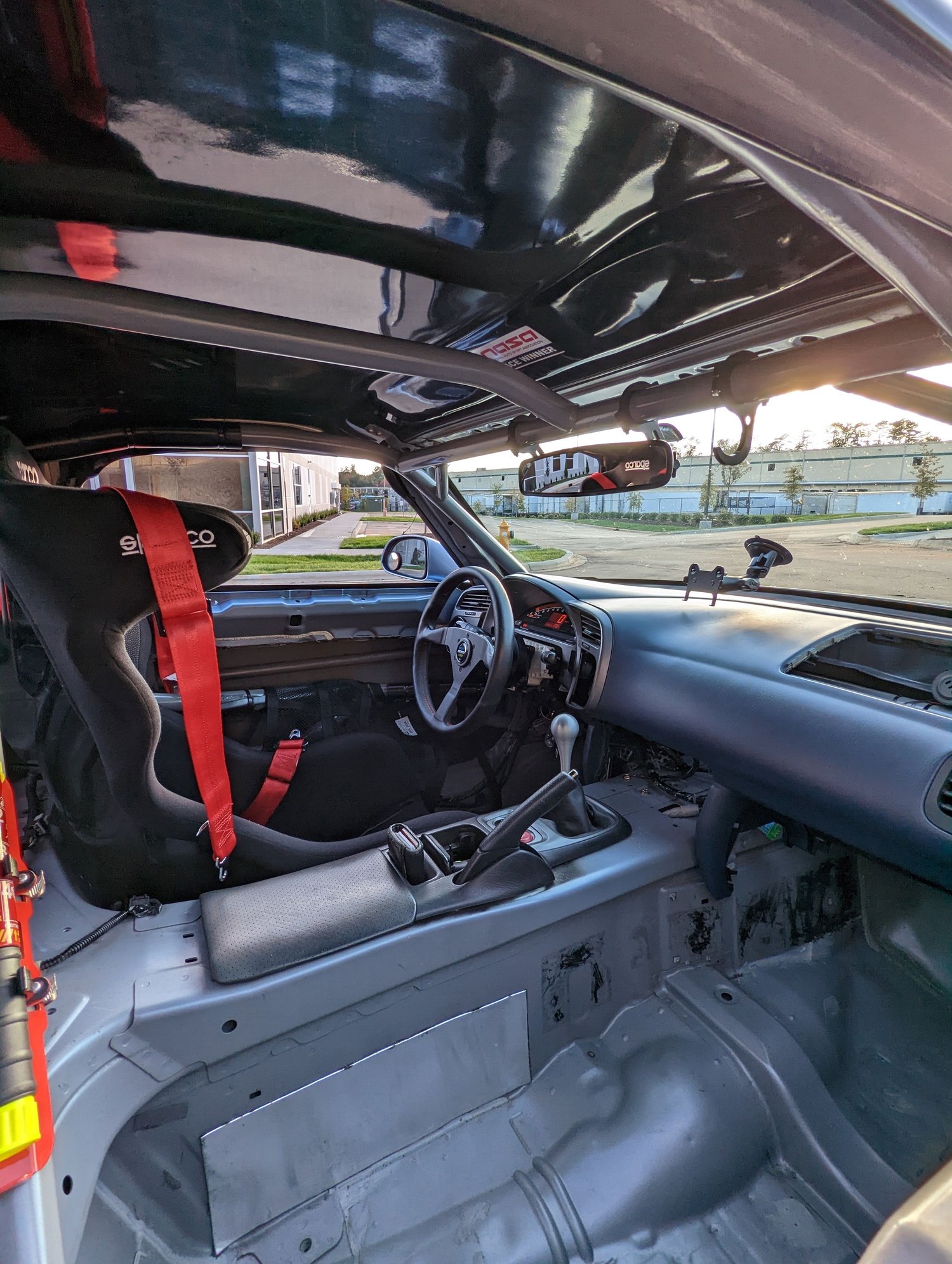

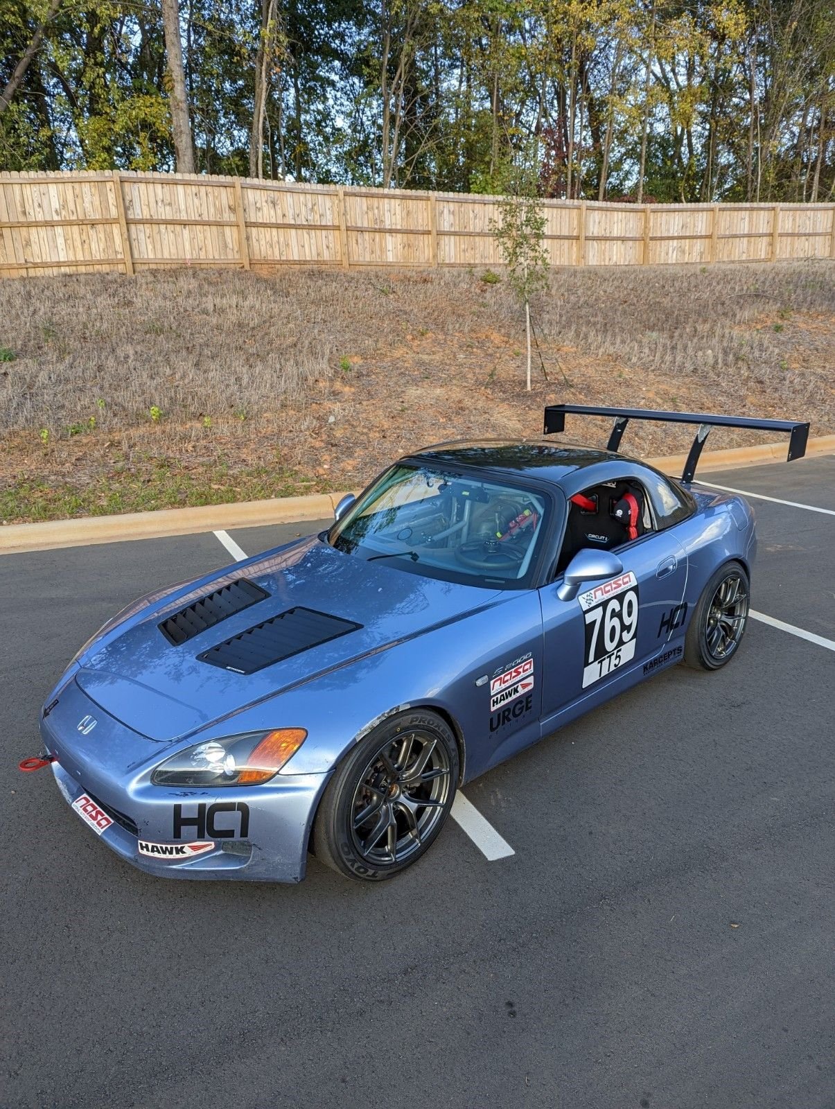

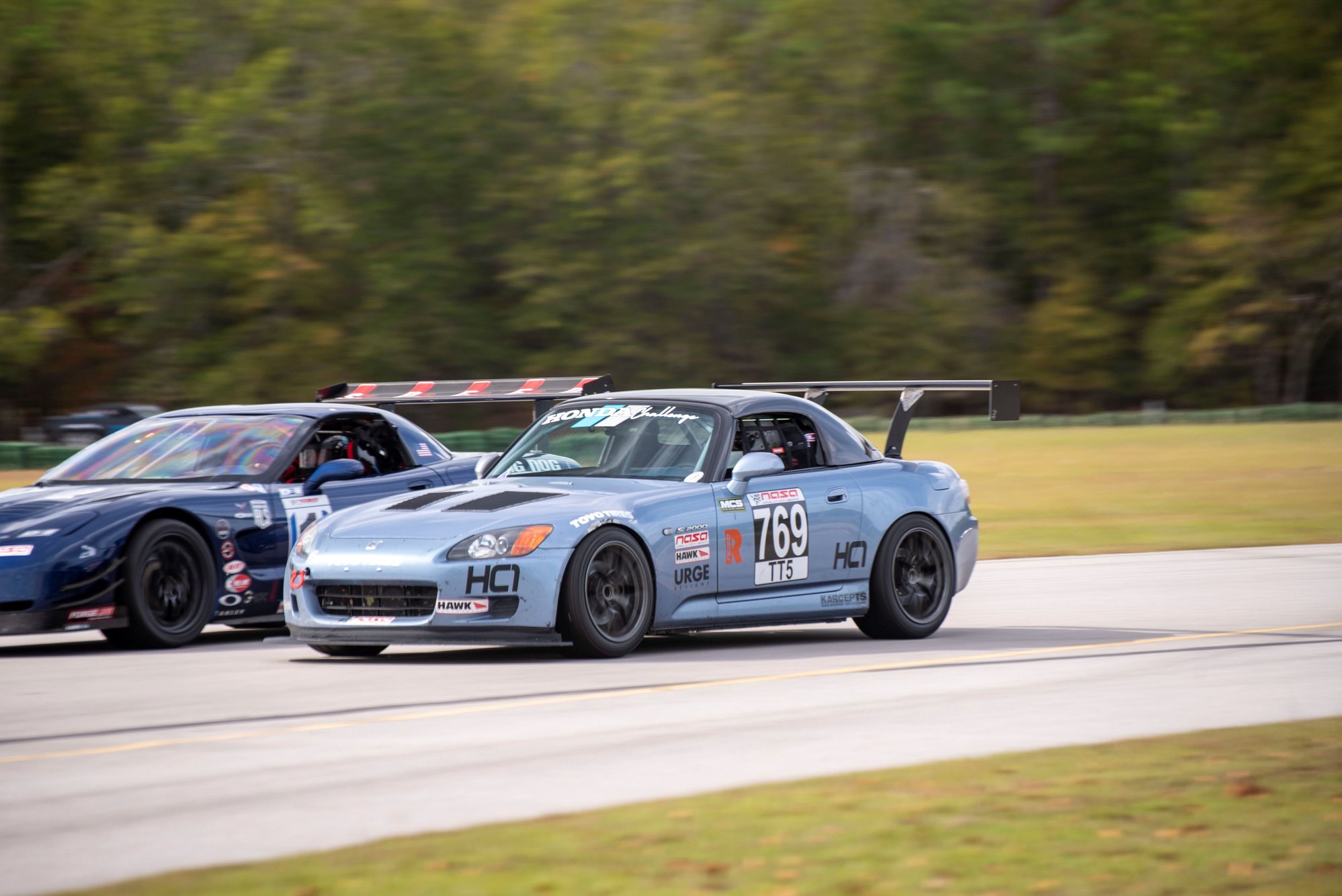

Shake down at CMP was a success. Car is almost completely dialed. Need to corner balance it.
Waiting on parts from 9Lives for the splitter before installing. Need to wire up the cartek kill switch this week..
Comp school November 4th... Lesss gooo

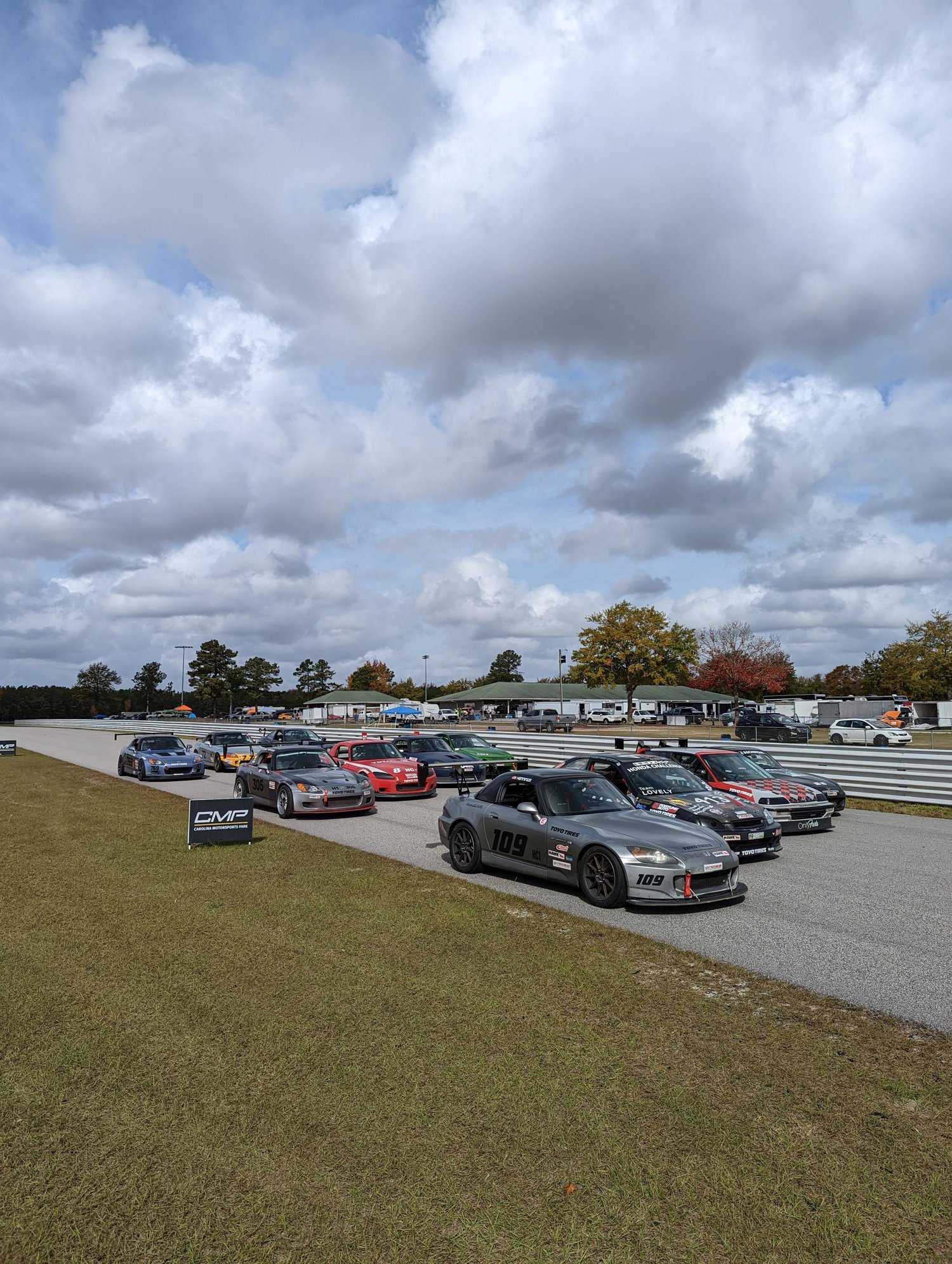

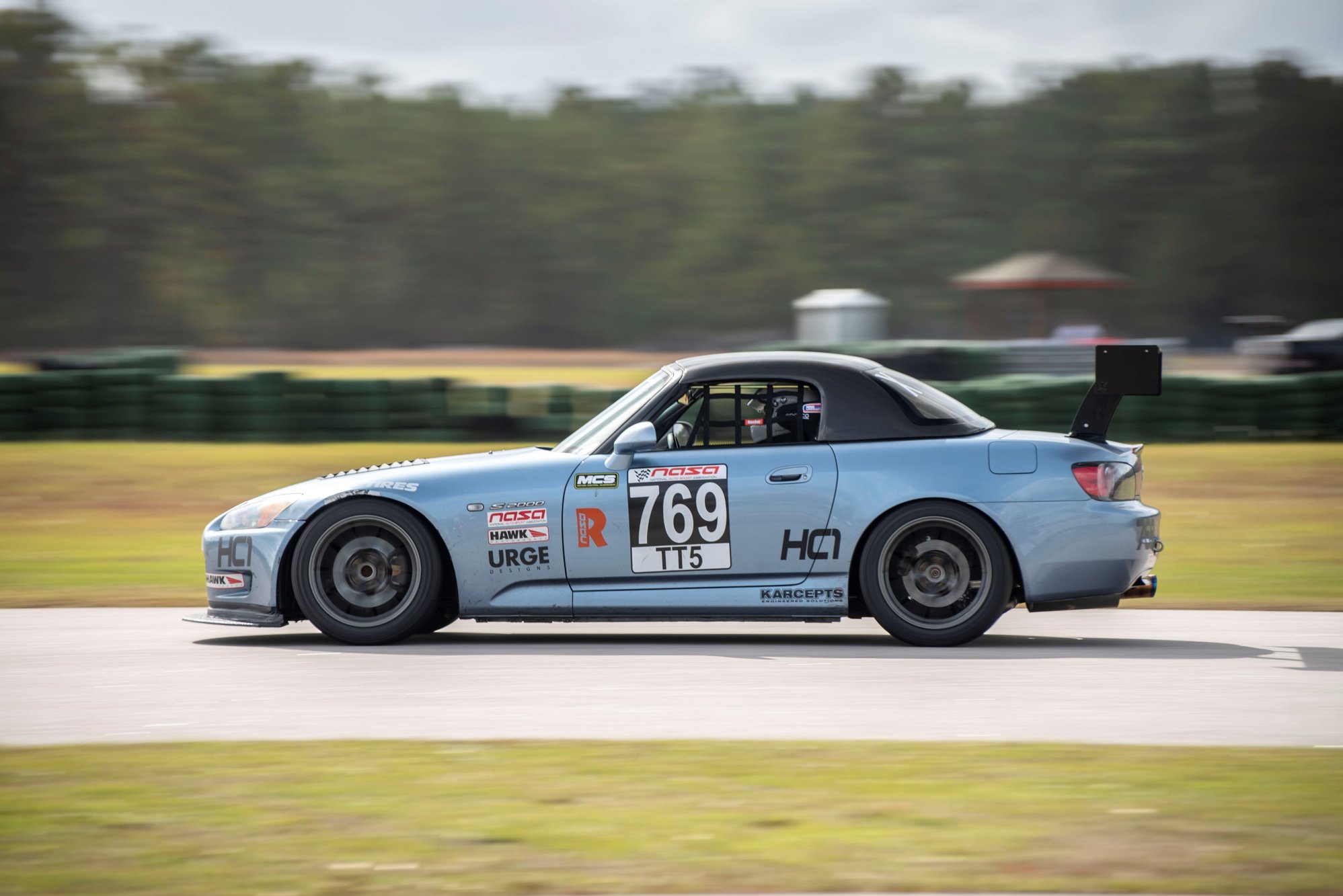

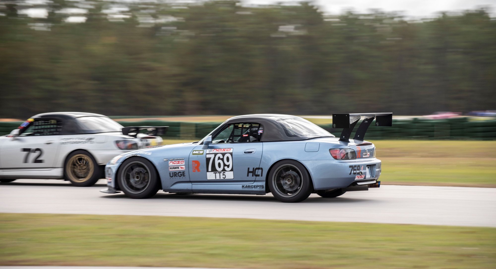

I'm hooked on w2w... Comp school was A LOT. It started at 8am and went until 6pm. Mock races had about 40 cars and we were going 4 wide into turn one at CMP. It was a riot.
We had 8 s2000s in H1 but one blew his diff apart 1st session on Friday. It was challenging to start in the back every race due to being a rookie but made for some damn fun driving.
Had a little contact with a spec e46, gave me a love tap to my rear bumper. It was either brake to avoid hitting a slow car in front at the exit of T8 or hit the slow car.. E46 was 3' off my bumper and had milliseconds to react. No harm done.
