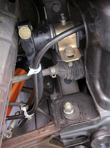

What mine looked like when using Gendron with non BB mounts. I am not sure it rubbed, but it was within 2 mm for sure (probably less). I later rerouted the reservoir hose and upgraded to the BB mounts, although the clearance is probably about the same now. I keep an eye on the inner tire wear and have not detected any rubbing so far. I believe the clearance increases the lower the car is sitting. Here it was under full droop.
Yep, I figured most Gendron bar users would be experiencing some amount of rubbing. Unfortunately, using the upper mounting location like Nick did, means the clearance doesn't increase as much compared to the lower mounting position. In your second picture, imagine having the bar mounted much closer the visible bolt that fastens the sway bar mounting bracket to the chassis. The height difference between my approach and the BB Gendron mounts is between 2" and 2.25". Thanks for the pics.

Pretty sure I don't rub with gendron with bearing mounts, although it's close. I have the J's ball joint as opposed to the SPC, maybe that makes the difference.
