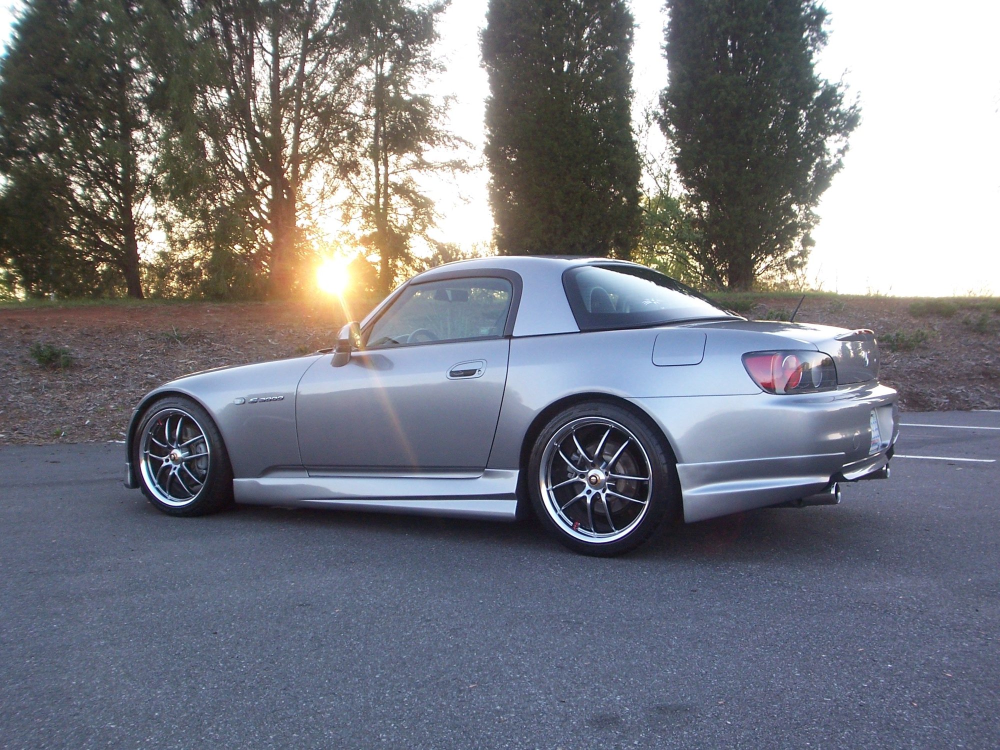

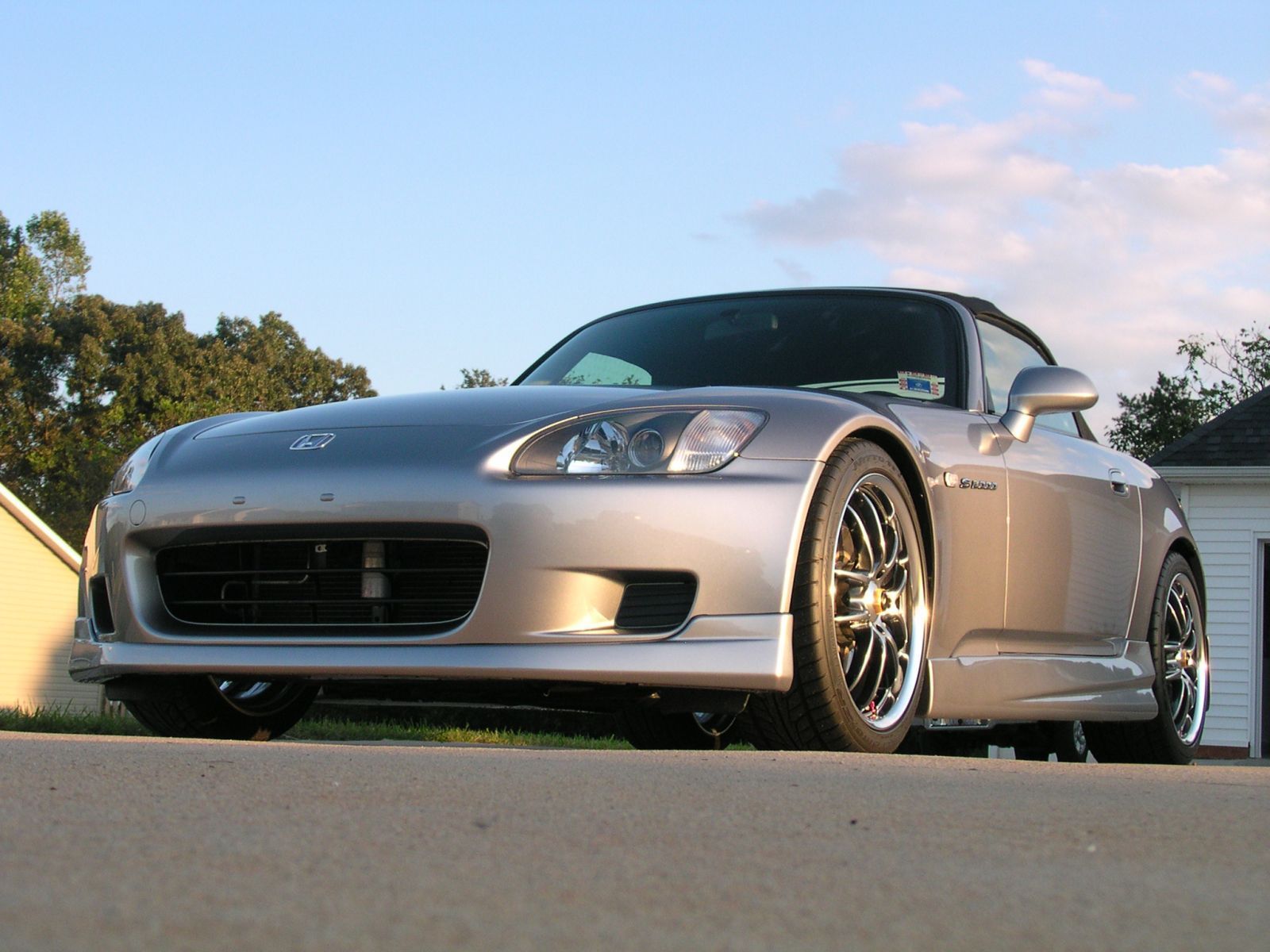

I've had H&R's on stock shocks for the past 10k miles. They lower the car .75" in the front and .6" in the rear. Not a HUGE drop, but enough to close up some gap and make my 18's look good. The ride is probably pretty close to stock. No harshness or wallowing or bouncing. I don't track my car and I don't think I've ever even driven it 7/10's. I can't remember how much I paid but I'm thinking in the $200 range. Here's a couple of pics to give you an idea.
