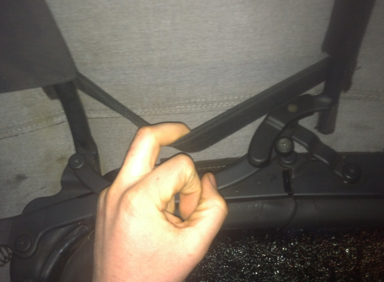

After looking at pictures of other S2k's i realized my top isnt going all the way down either. I just bought it and had no reference of what a top all the way down is supposed to look like. After reading about those elastic straps, im guessing i shouldnt be able to pull them down easily with one finger like this?
The resistance in the strap is so loose you could hang a christmas ornament on this thing and it would probably sag

Everyone uses these easy to install straps for $20. They all go bad in a few years so you need to replace as the elastic stretches out.
http://www.modifry.com/index.php?rou...&product_id=86
