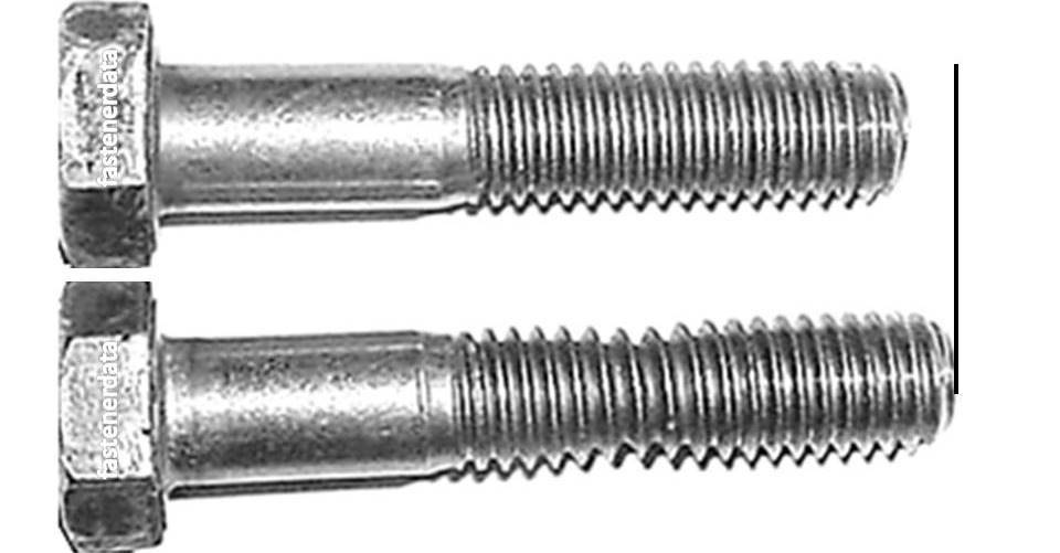

Any chance those bolts got stretched in this tightening process(es). I'd prolly take them out, inspect and measure them. You won't get proper torque with stretched bolts.
Just a rule-out. Good luck!

Visually compare & measure the bolts against each other.
