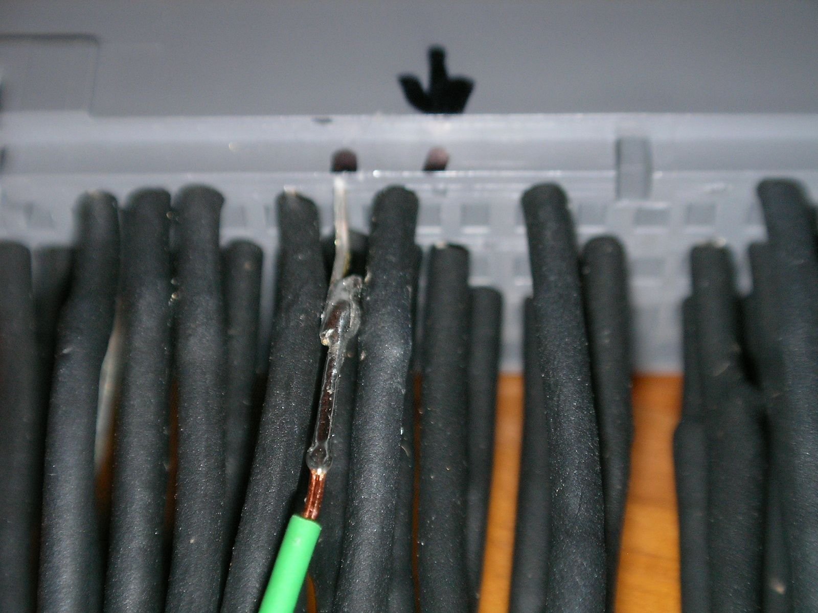

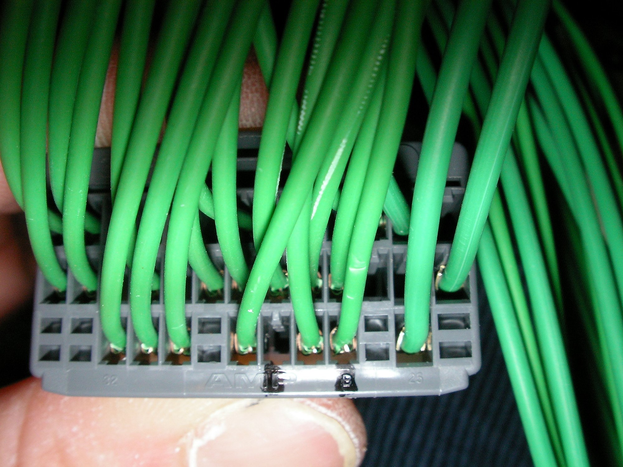

Reading your tales of woe made me open up my sealed package and tackle the job myself.

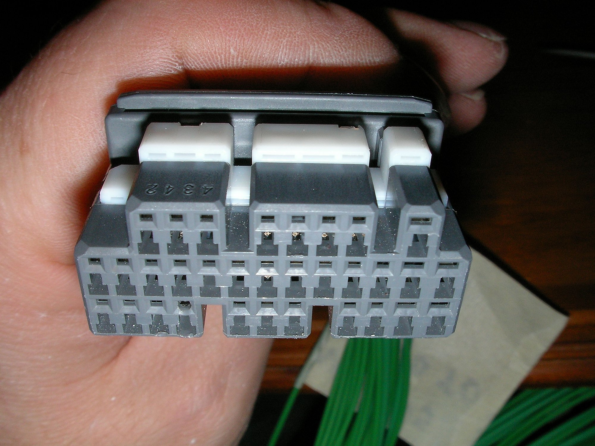

Right that white bit you don't need to push up high like Stratocaster said, this is enough.

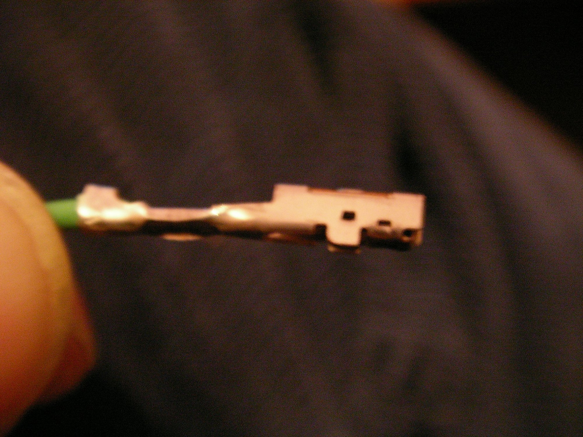

Then I got a tiny watchmakers screwdriver and stuck it in the block, you have to get it in the right place.
Then they just pull out.
Stick it in the right hole on the connector and snap the white plastic bit down.
Then you need to unsolder this and stick it in the other hole, resolder and shrink wrap it.

After a couple of nice words, i managed rip P29 cable, spliced in the white plastic of the connector (yes spliced right in it) and got out the pin. soldered a new cable and put back in P31.
The other side was done perfect without any issues.
Time to get it back on the car, took a deeeeep breath and turned on the key.
AND
NO CEL
took the car out, wait for the 3 bar, and WOT to 4th gear and no flashing CEL
FINALLY step one done.
