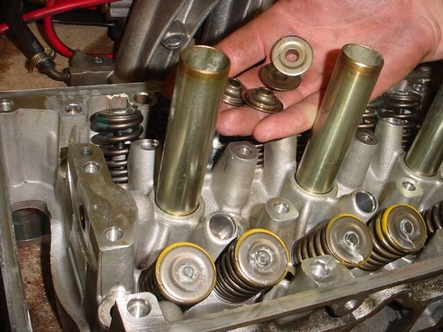

Most times the retainers will be cracked on the bottom, which you cant really see without a dentist mirror or removing them to inspect.
You can kind of see the messed up retainer in the mechanics hand, this is the rebuild on my car that is almost done..

Thanks for the reply darkfx. I saw on there that a dentist mirror could be useful in looking for cracks because you cant see them while they are in there. I suppose I will try and find one of those to try and check to. That picture helps as well I see what crack s are on there you are talking about. Thanks a lot for the info I will probably take a look at all this on the weekend.
