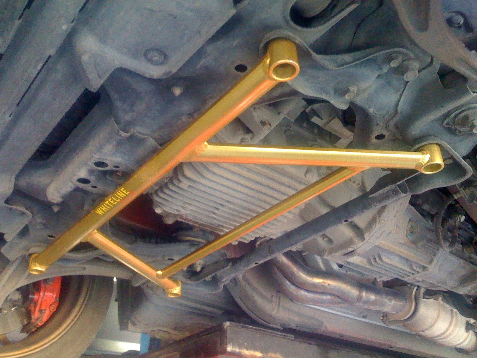

As promised here is my feedback regarding the installation of Muz's Whiteline X-Brace.
I cannot say that I had any issue or trouble getting it on the S. I think its normal, that you have to play a bit around with the brace and first screw a few turns all four Allen bolts. Then you tight them carefully all around with no torque wrench at first. Once you are done, then you finally torque tight those Allen bolts as instructed by Honda in its S2000 manual.
Tomorrow morning I will test this product on a small track and see how it feels. Here is a quick photo I took with my phone's camera.
