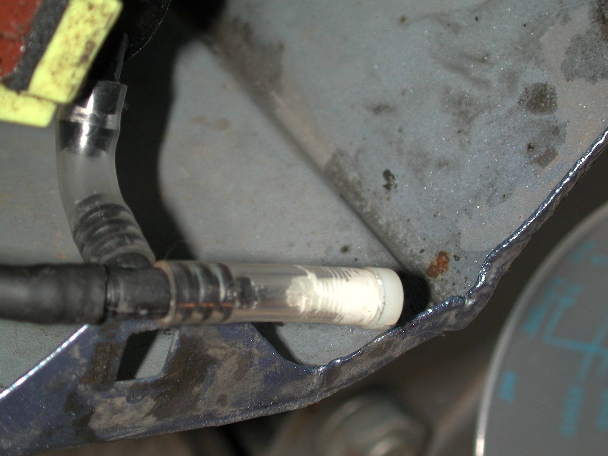

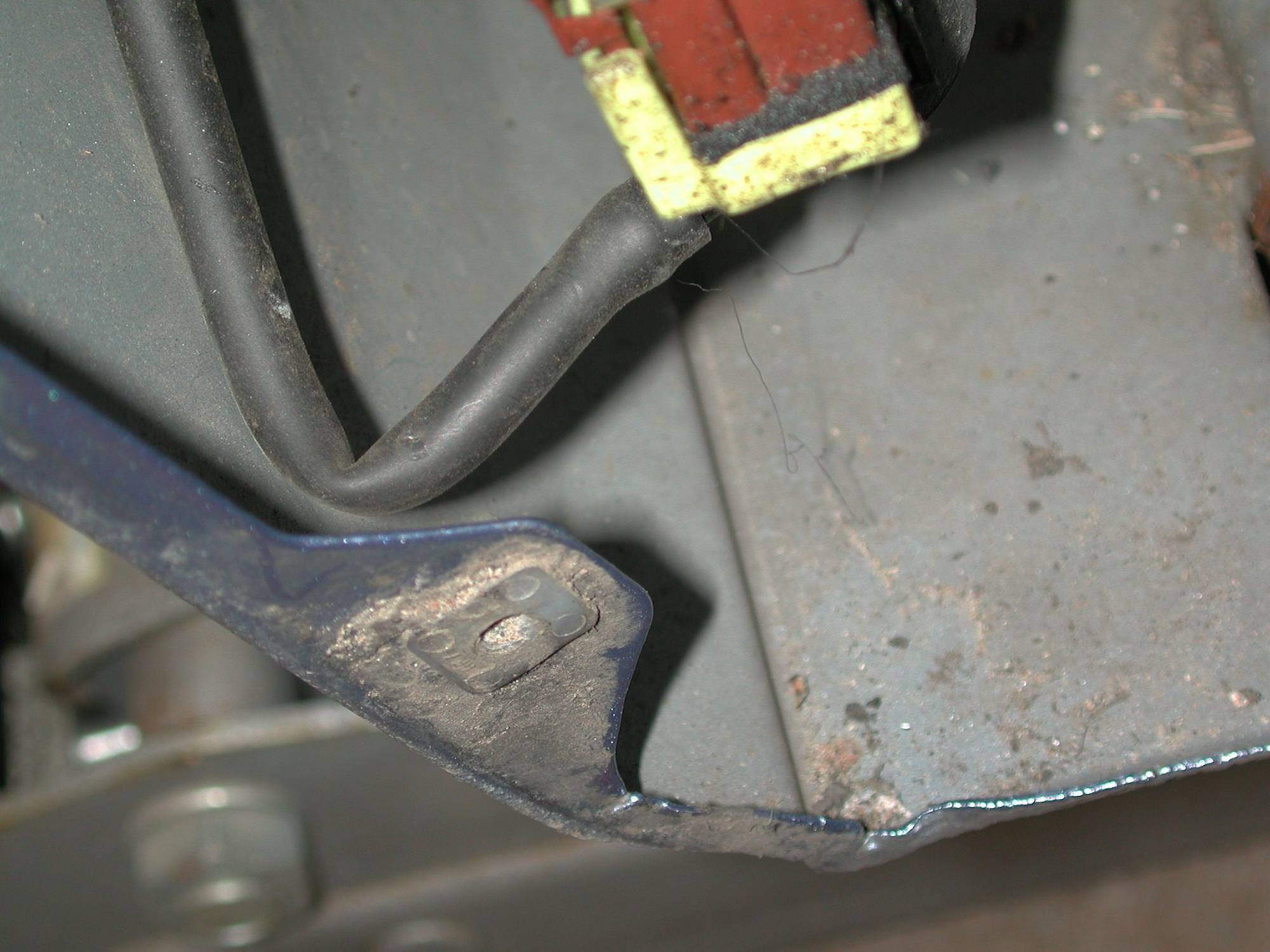

Here are some pictures of the offending pipe, where it's located and the fix I used.
The location of the bottle in the drivers side wing:
The kinked pipe!
My fix using a T piece with one arm blocked off (it was late on Sunday )
PS It's worth buying some of the replacement plastic clips that hold the liners in the wheel arch. They're about 90p each and easy to break, getting them out.
