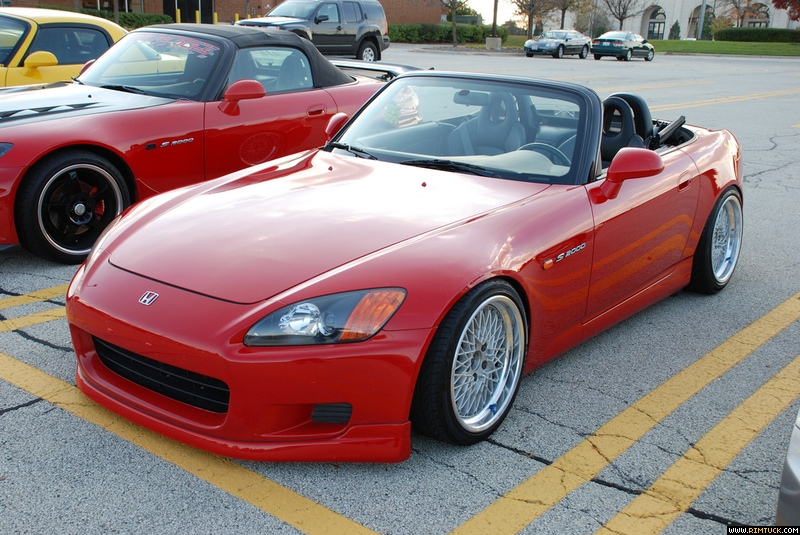

Ive got pictures of two cars on non-standard wheels for you:
The top one is 18x9.5J ET20 and the bottom is 17X9.5J ET38 - theres some camber on the top one but not a lot. According to your guide though, neither set of wheels should fit ............. but I know both cars and know these sizes are correct.

) and Ive been looking into the fitments myself. Ive got pictures of two cars on non-standard wheels for you:

This thread is not for extreme fitments and that has been stated several times. The data presented here is for people that don't want to risk rubbing with stock setups. It was gathered from real-world examples on this very forum.
The wheel and tire setups in your pics DON'T fit according to the focus of this thread.
Different people have different definitions for fitment. IMO, I would not call the wheels in those pictures a "fit." The wheels and tires on those cars clearly stick out.

Thats cool - I live in the world of extreme fitments and to me that white one looks about right. In fairness to you my brother doesnt like the white one either
