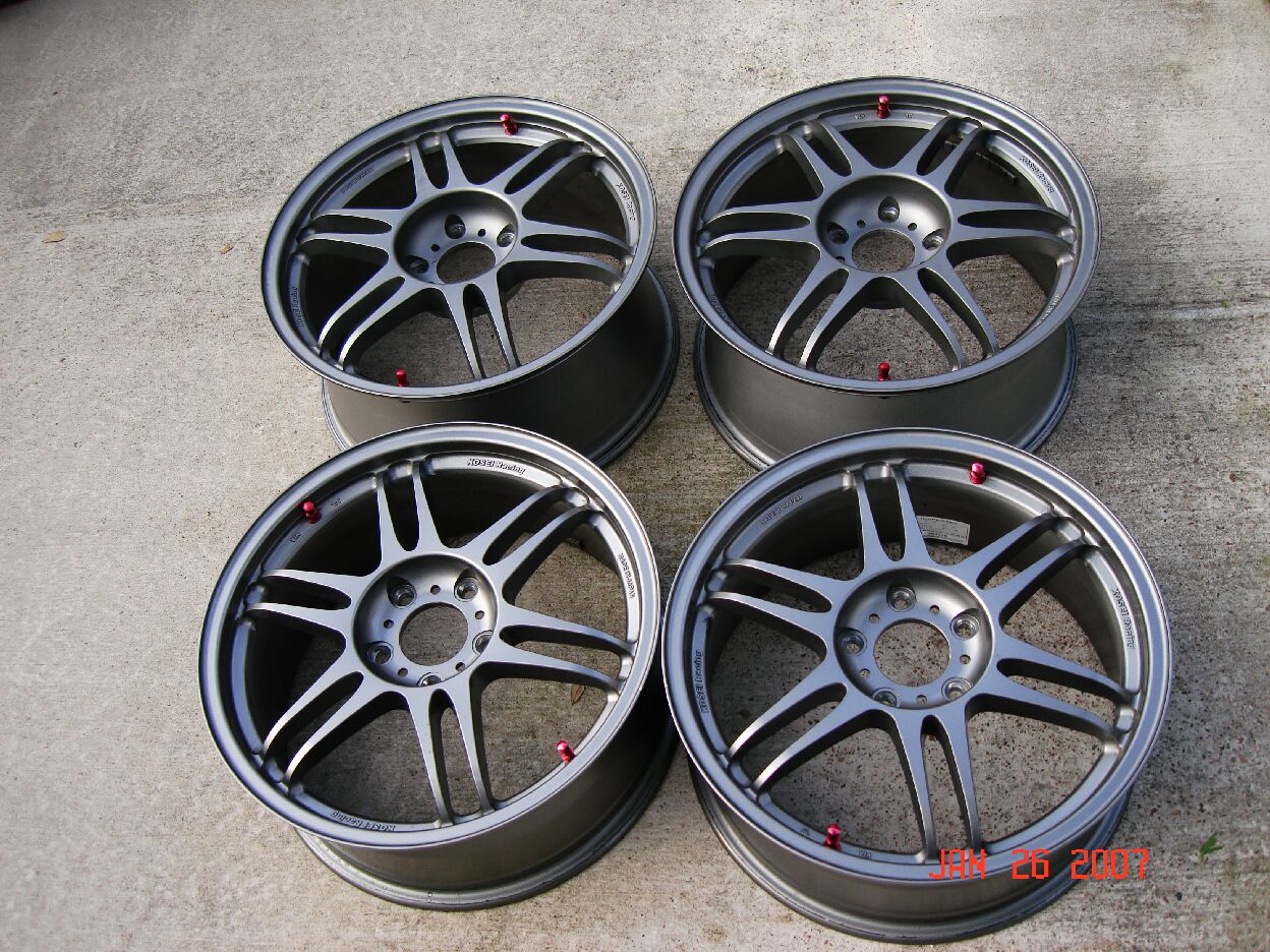

oh yeah sorry forgot the mention, pockets not too deep i would be willing to pay $400 per wheel but would prefer under $300. There was at one point a nice set of koesi K1 for sale on tirerack that were light and inexpensive (though not sure the offset) but they dont appear to be available any more. trouble finding them. But they were under 17lbs and 250 a wheel.
http://www.s2000.com/pictures/data/500/DSC05053.jpg

Your best bet may be to look for a used set of volks or wedsports. There is also a number of wheels around 19 lbs that are fairly cheap. TSW has a few and Enkei has more than just the RPF1. Do some looking. Those Koesi look very much like RPF1's just a slightly different spoke.

what i really dont like about the RPF1 is that fat rim and the spokes not going out to the edge of the wheel. It makes a 17" look like a 16 or 15. Otherwise the price and weight are perfect.
