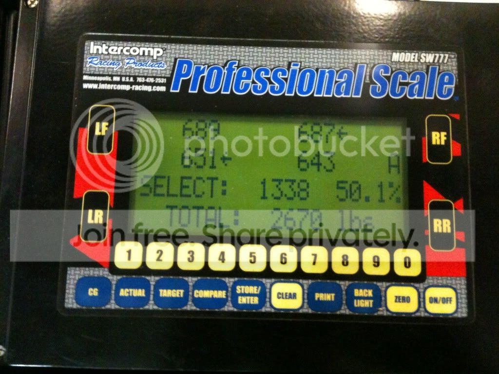

Here's my Evo's corner balance in 2012, in SM-class autocross trim, after taking as much much weight out of the FRONT of it as possible... still horrible:
In comparison, here's the corner balance of a typical STR-class autocross build S2000... roughly 51.5% front, 48.5% rear. FYI, this is a shot of scales' display without the driver... the car was balanced with the driver sitting in it, but when you're running really stiff race springs, taking the driver out of the equation doesn't affect the corner balance much:
