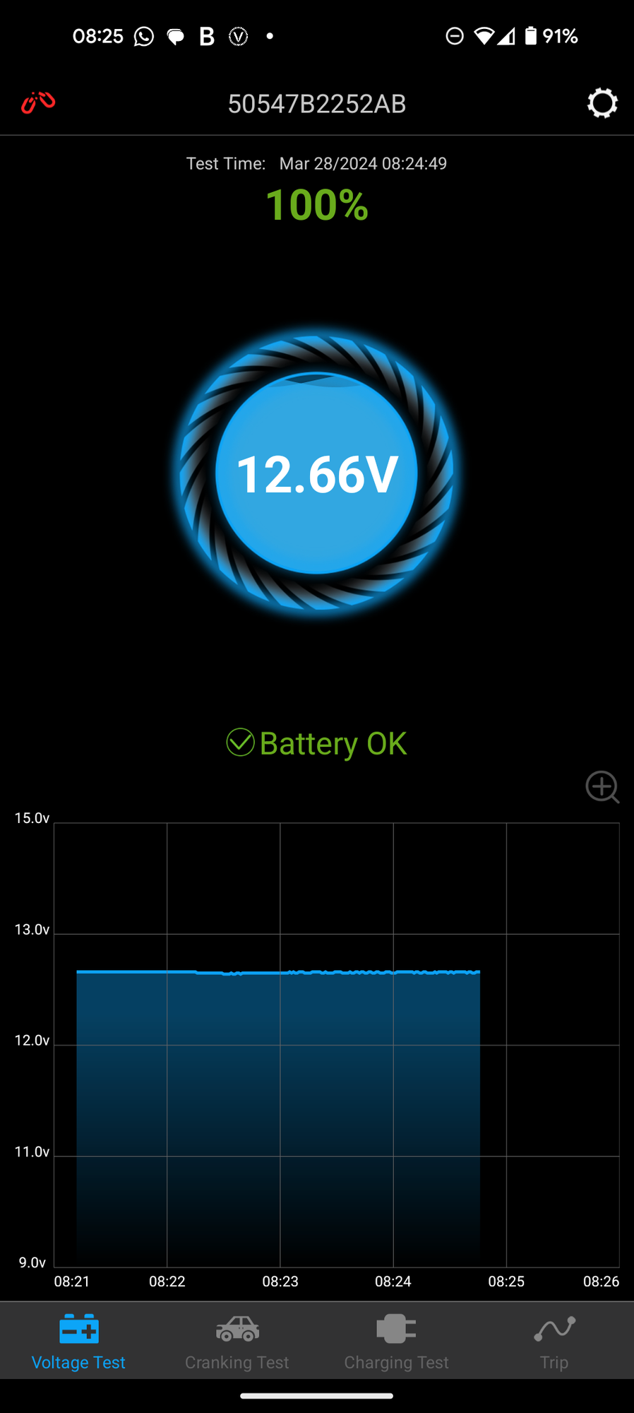

I installed a battery monitor for peace of mind
I had left an OBD dongle in so perhaps contributing to my issues but charged yesterday and she is very happy today
Another option is to pull the fuse for passenger handles, above your right knee when driving
Don't know if it will throw a code though
Handles are c£500 a pop and Uber Plastique parts, don't look very serviceable apart from lube but mine has been behaved since that in some... Mixed... Weather
Fingers crossed
