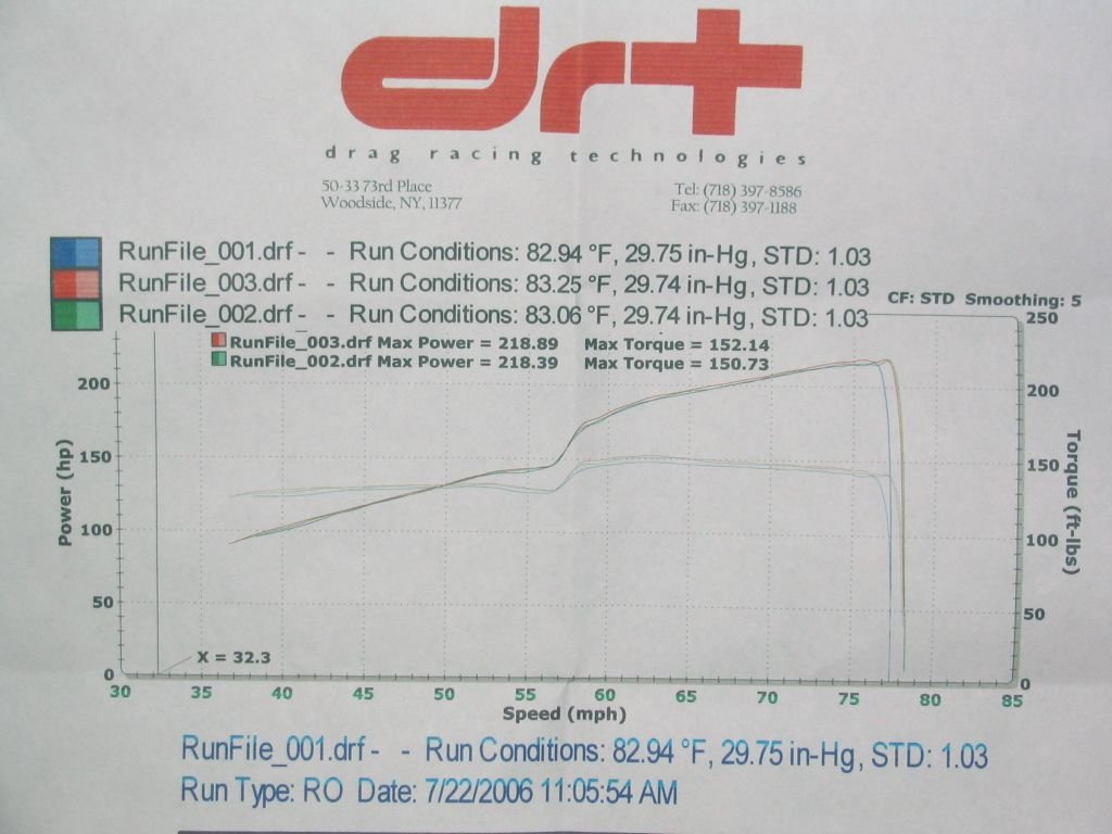

don't know if you can read that but maybe you can add it to your chart wildcard
I'll add it no problem, but since your dyno is speed based and not rpm based, and you have an AP2, I need you to go out and tell me what rpm's each of those speed values are recorded at. Make sure you're in 4th gear when you do it.
