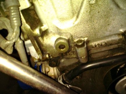

Access screw (to pull the retainer pin) - removes with an 8mm Allen

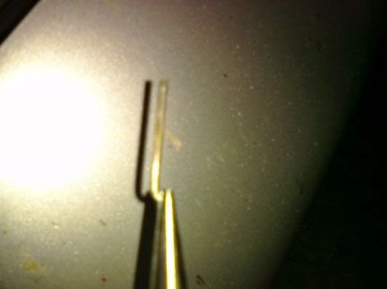

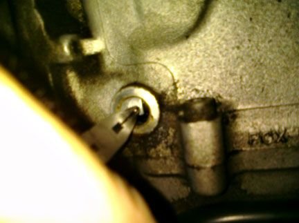

Insert the new TCT, tighten down the bolts and see the pin inside the access hole. Grip with needle nose pliers and pull
You'll hear it snap back into place. Replace screw and you're done. Best to make sure your oil is topped off before starting the car.
