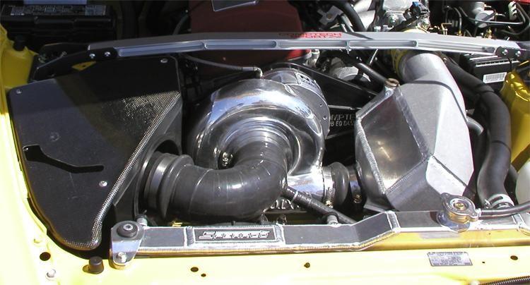

I saw a prototype of the Comptech intercooler at Sacramento S2K Days this w/e. They claim it could be ready for sale in as little as a month, but had no definite date or pricing yet. They say the initial version will have the same boost as the non-intercooler model. They will also offer it as an upgrade for existing kit owners. Below is a photo.
From earlier posts, I got the impression that the Comptech doesn't use crankcase oil for lubrication like the Vortech. This isn't true. While the Vortech taps into the oil pan, the Comptech has an adapter that uses the flow to the VTEC controller. (I'm guessing that the Vortech design probably provides better flow, but it requires more work to install.)
At the same show I saw VTEC Racer's Vortech equipped S that was producing 311 rwhp with stock plugs. (The plugs were causing misfiring above 8600 rpm, so he'll be testing again with cooler plugs) The car had no other engine mods. I ran with him for several hours, and the car is fast, fast, fast.
Here's the Comptech:
