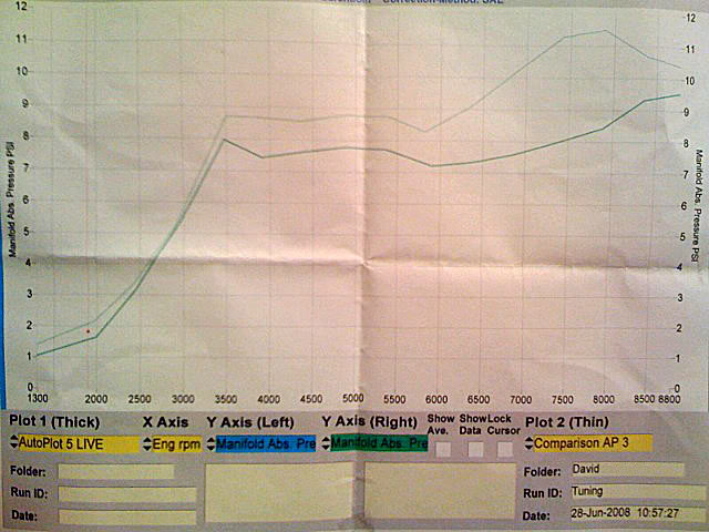

Originally Posted by stewie69,Jul 10 2008, 06:28 PM
im running the 3 1/2" megan exaust and megan test pipe mine barely creeps to 9 psi and spikes at 10 still havent went past 7000 rpms though have a date with the tuner in 2 weeks
7500RPMs is where the violent spikes happen on AP1s.
Be careful. If you creep under 12psi, with a large pullback on timing, you should be able to hit under 10.
