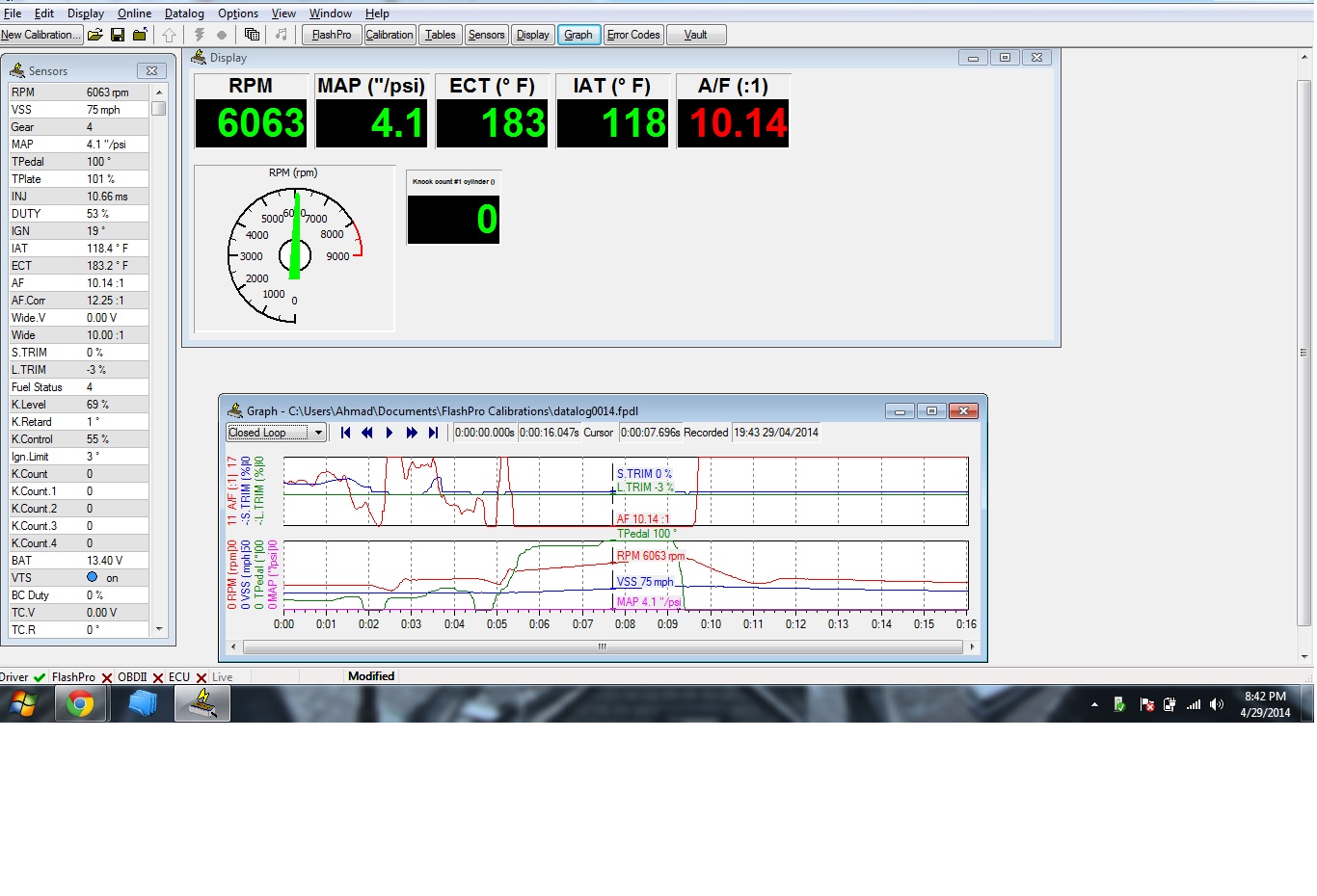

Hi guys, i just datalogged my s2k and im actually pretty new at this but i noticed that my air fuel ratio during WOT was around 10.14 and 12.25 (corrected)
I am confused what the difference between the two are. i did a bit of searching but didnt have any luck, other than they both will be different from each other.
my current set up
2006 s2000
sos stage 2 supercharger with 9psi pulley
rc650cc injectors
berk 63mm high flow cat
divert-er valve is dispensing to atmosphere
stock cluck and flywheel
91 octane
tuned from a very reputable shop in so cal
here is a screenshot of what i am talking about. throttle plate is 100%
Attachment 189269
shed some knowledge on me guys, i dont want to blow a motor lol
also temp outside was 93 and i smelled my dipstick and no smell of gas!

10 is kinda rich. 12 is a good target for WOT in VTEC. Rich is safe, but you're sacrificing some power when you run that rich. And you do start risking fuel wash.
Would you know what af, corrected means? This value is at 12.25
