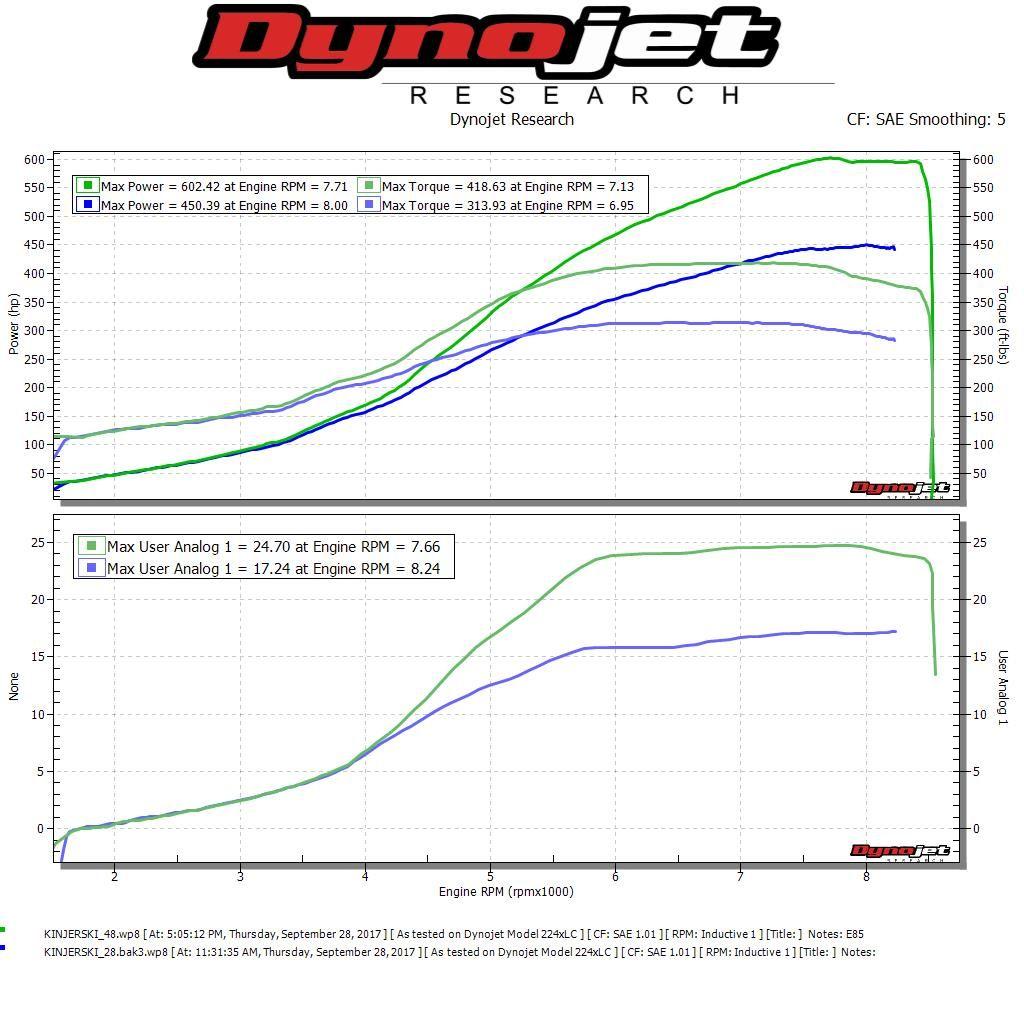

450 whp at 15psi on 93 octane, and a surprising 602 whp on E85 at 22psi.
I told the tuner to keep going up on boost until the clutch slipped, well it never slipped! The power tapering off with 602 at the end isn't a big deal, we could have spend more time leveling off the boost pressure to redline which would have eliminated the power drop, but 3 pulls at 600whp was more than enough to show the potential. Injector duty cycle was 98%, 22psi (dyno Map sensor reads 2-3 psi higher than Kpro), and the clutch is an ACT HDSS pressure plate with an OEM Honda clutch disc.
Currently I am running 15psi on the street., which is around 525whp. Hondata traction control has kept the tires from spinning in 3rd gear. Overall, the power feels great!

Sick ass numbers buddy!
I forsee a new clutch in your future if you drive that thing on the E85 tune. I thought you only had 1000cc injectors? Is the boost on the E85 tune dropping off a lot on the top end hense the leveling out on power?

did you use the boost regulating disk?

Damn good numbers!! Looks like a solid kit. Owners plz chime in on any issues you may encounter in the future. This just may be my next setup if it holds up no cracking/warping. I feel, reliability has become top priority on my checkoff list nowadays.
