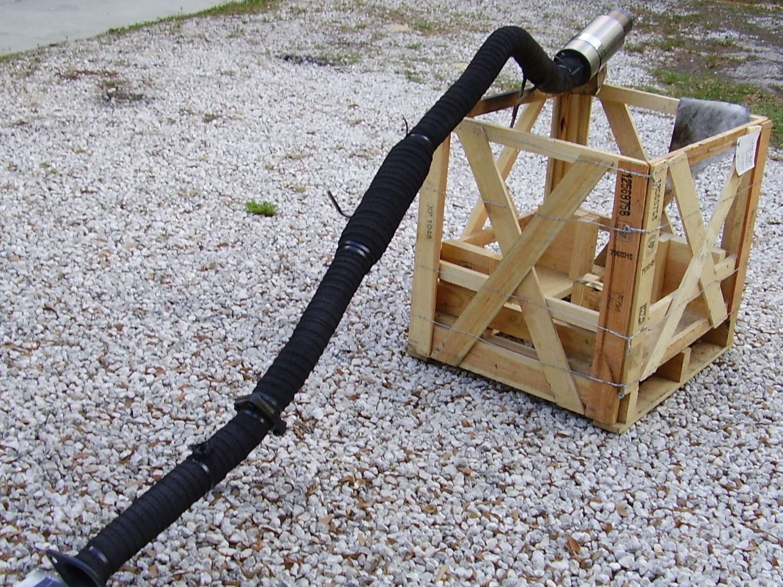

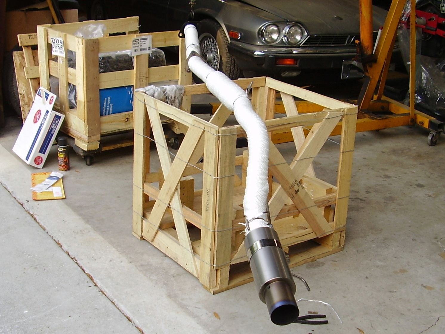

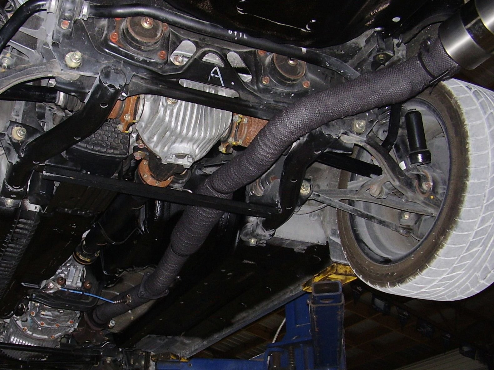

Here is a full exhaust I did

No DIY but, it is not that hard to do just time consuming.
You want to work from the header to the muffler because, the over laps will be with the forward movement of the car and not going agents it.
On the exhaust posted above I wrapped it wrong
This is the brand of spray I used. It can be found at Advanced Auto Parts, Ebay, and most speed shops.
This is a stainless steel Megan header. It is sprayed black first then wrapped, then sprayed again so water repels off the wrap.
Use good marine grade stainless steel ties to keep things in place.
You will also want to use a surgical mask and gloves when you do the install. The wrap is fiberglass and it will make you itch and irritate your throat.
I live in Florida a semi tropical climate so I get caught in the rain and drive in the rain sometimes.
The biggest reason I use the wrap is sound deadening.
The engine exhaust sound exit
