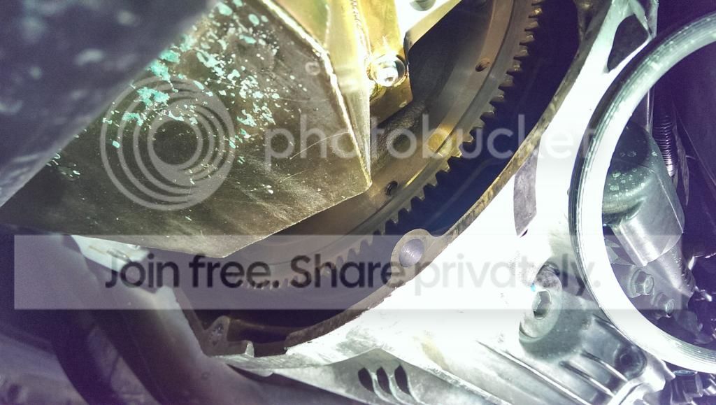

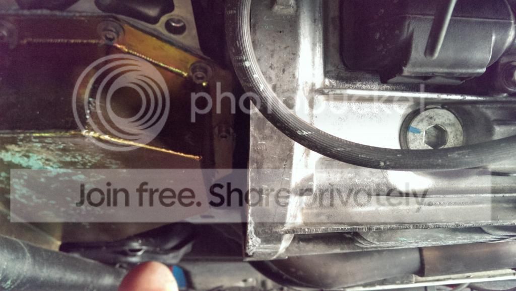

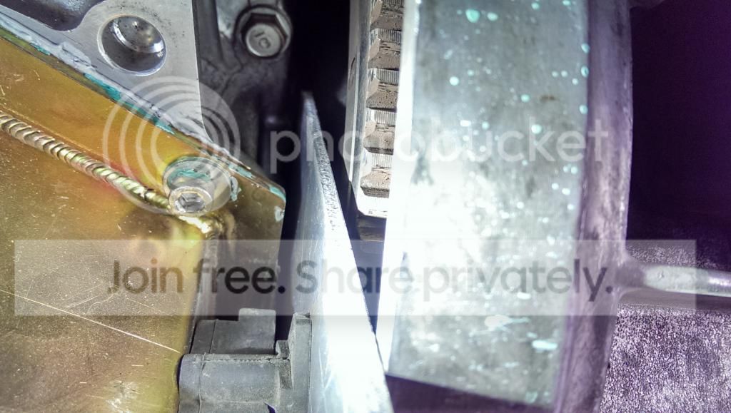

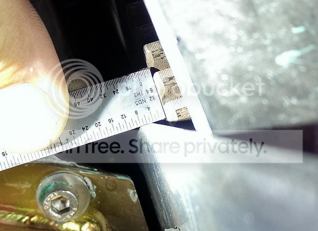

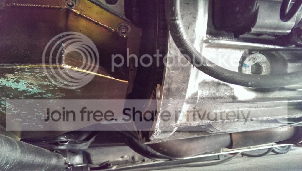

99SH,
Thanks for the pics. They are very helpful. If the ring gear on the flywheel is only ~3/32" away from the cover, I can see how w/ an AP2 flywheel (if it does in fact have a thicker back beyond the ring gear) there could be contact. Just good for people to be aware of. I'll be sure to put a straight edge and check the clearance on my flywheel for comparison purposes when the time comes.
