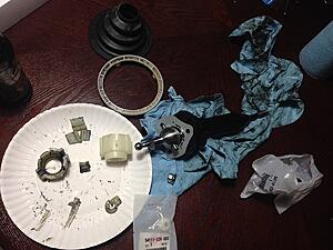

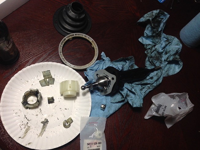

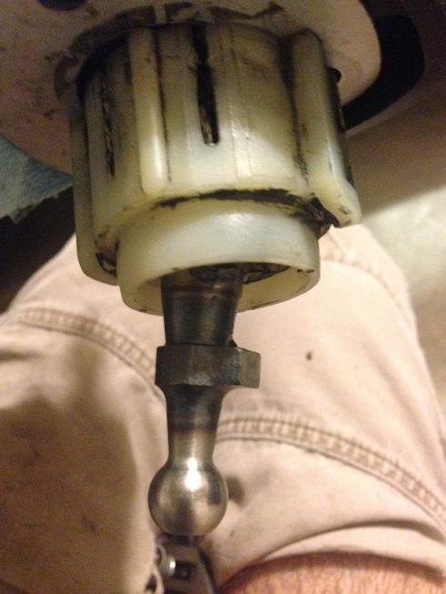

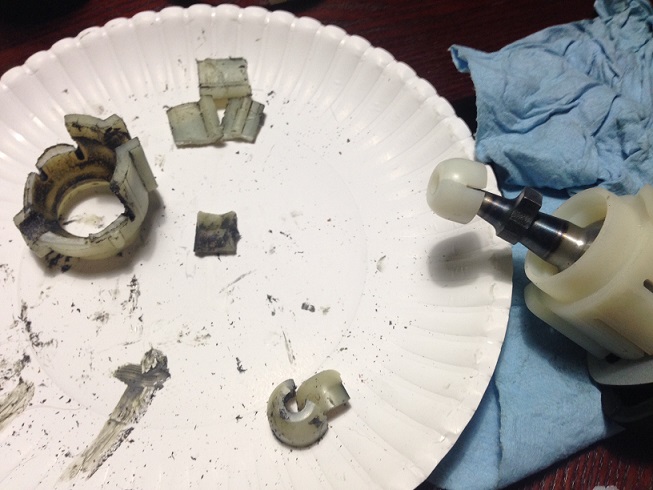

I regreased my shifter this weekend. Bought more parts than I needed to... I'd only replace the two plastic pivot parts.
Getting the bigger piece off was a major pita. Putting the new one on was easy enough with some kind of surface with a hole to use as a press.
Unfortunately the smaller piece is not as durable... mine cracked when I was putting it on, even though I was as careful as possible.
I just stayed with the cracked piece since it didn't seem to matter too much.
edit: Looks like hot water would help protecting the small pivot cap from cracking... I should have read the whole thread Getting another one shipped from Majestic Honda would be $12.90 + $13.50 S&H. Yikes.
Shifting is massively smoother after the regrease, but I was hoping neutral would have less play... didn't seem to affect that at all. I guess that's controlled by some piece in the actual transmission.
