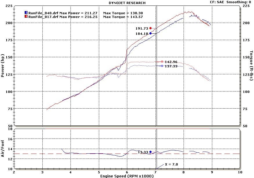

tuning went Great!!! the Vafc is a little tricky when you first start out, because I had no instructions, and I found very little on the web about tuning.
but i managed to get a still very safe A/F across the board, with nothing over 13.5. I will tune futher when i get my 3 inch ( mybe today )
but my peak went from 203WHP Baseline to 211WHP, so peak went up 7-8 HP. Trq only jumped up 2Wtq, LOL but Im VERY happy about the results I got from 8200RPM to redline, between 12-15 WHP over stock, @ 8700 before i was making 189whp, now thats up to 203.
I will post my dyno sheet sometime today.
VAFC one of the BEST bang for the buck mods. even on a stock AP1

again my baseline may seem a little lower, this was done on our AWD dynojet that reads a tad bit lower than the 2wd.
and for comparison here is my VAFC tune vs my T1r headerback. remember my vafc tune is only with these mods : k&n drop-in, Krankvents, and the Hondata IMG.
On a side note, the Krankvents DO add midrange power, 2-3 HP the whole way, except at the very peak. good 100 bucks spent along with way less oil consumption when the car is beat on!

P.S.S
I droped V-tec, and thats all i did, i didnt do ANY fuel tuning in that area, so there is a DIP in the Vtec engagement area, I will work on that next week, along with the new exhaust

Very cool dude. I think with the 3" exhaust you'll hit the 220 rwhp mark.
