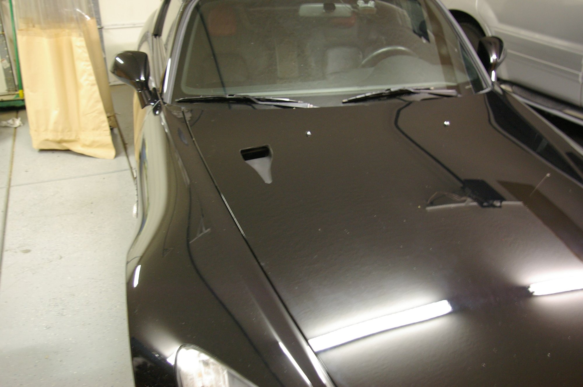

Got the NACA duct cut in and bonded. Will get some better pics once I get back from Semicon and can repaint it.
Before anyone asks:
No - It is not finished. I plan to do some finish work and use a can of touch-up paint for now. I have an AP2 bumper (and hopefully some 04 head-lights) to install when I get time - then its off to the body shop to get the front-end repainted (Thinking September).
Yes - it helped out in reducing the IAT. The intake charge at the inlet of the supercharger dropped about 40F at anything over 35 MPH (went from 165 to 125 - current ambient temps are 100F). Thinking I will get another 20F by putting a simple heat shield in to focus the air coming in on the filter. The more interesting change was a 44F drop in IAT as measured on the IAT sensor. I cruised around first with the duct covered (ghetto tape and cardboard), then open, then again with it covered - rinse, wash, condition, fully repeatable....
As far as water coming in I am not really concered. The duct drops behind the filter and I live in Phoenix. Not planning to do a water trap - worst case is a wet filter, but no water lock possibility.
The duct is fiberglass and is bonded using marine-grade multi-substrate bonding putty from loctite. Actually saw a guy use this stuff to glue together a broken/cracked lower unit on a boat so he could finish out the weekend fishing. The duct itself was provided by a friend that makes ducts and scoops for a company that makes experimental aircraft.
Wlaurent....
congratulations
the temp change seems reasonable
...and it looks prefect.
understated and functional.
that is exactly what i wanted to see you do
PS -- they say sharp edges are what NACA speced ---
the sharper the the edge the better this duct works

Originally Posted by slackfaster,Jul 15 2007, 09:06 PM
Wlaurent....
congratulations
The edges are sharp. It actually looks much nicer than the image shows - will need to get some pics up later this week once I clean it up and use some touch-up paint on it.
I was a little in a hurry to see if it worked - decided that I would finish it later.
