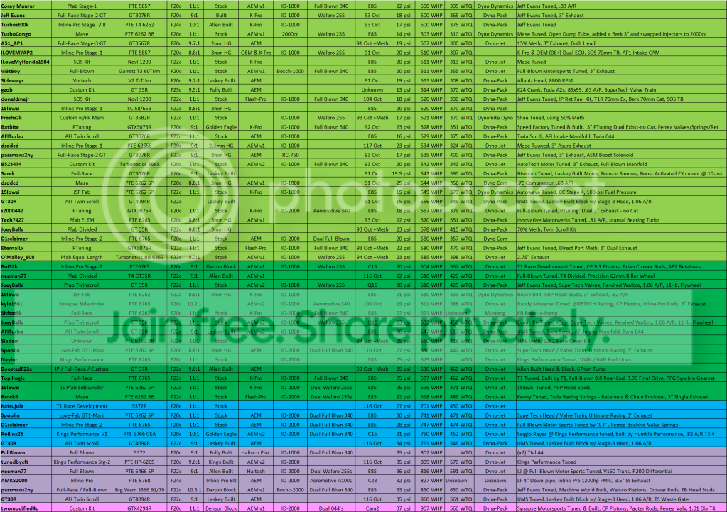

Looking at our power chart, I don't think you could make your goal with 1300cc...grant it, it would be close, but they'll prob be maxed out
