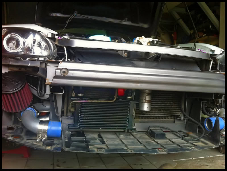

Just installed a custom cold air intake for the GReddy kit. Its really inexpensive and easy to do in a hour or so..
The parts needed:
3x 90 degree 2,25 aluminium pipe
1x 12" Long section 2,25 aluminium pipe
4x silicone couples 2,25"
8x additional hose clamps
Should be around $75-125 total...

I has some SERIOUS heatsoak problems and this thread gave me some idea's: https://www.s2ki.com/s2000/topic/872...induction-mod/
It worked out great!

Have you put it on the dyno to make sure the extra piping isn't restricting airflow and changing your A/F ratio? It looks great but that's worth checking. I did the same thing basically but with larger tubing..
Old Jul 12, 2012 | 10:29 PM
  #1508
Nyther's Avatar
Joined: Jul 2006
Posts: 1,008
From: The Netherlands
Not yet. I used 2,25" because thats the same diameter as the feed pipe and the filter's size.. So i have the same diameter on the inlet side.
Do you think it would suddenly restrict power? The piping going from turbo to ic is even smaller (2")
My af's are still a bit on the rich side and the boost remains the same... So it seems okay but now you make me think twice...
Old Jul 13, 2012 | 02:30 PM
  #1509
Torque Obsessed's Avatar
Joined: May 2009
Posts: 1,308
I don't know if it will restrict power or make more power. But either way, it could change your air/fuel ratio, which means your tune could be out of whack, which could hurt your engine. Or it might have no effect at all. You could try connecting to the e-manage and logging boost pressure & A/F ratio with it on vs. off and then you'd know for sure. (If you have those sensors.) Otherwise do some pulls on a dyno and log the data.
