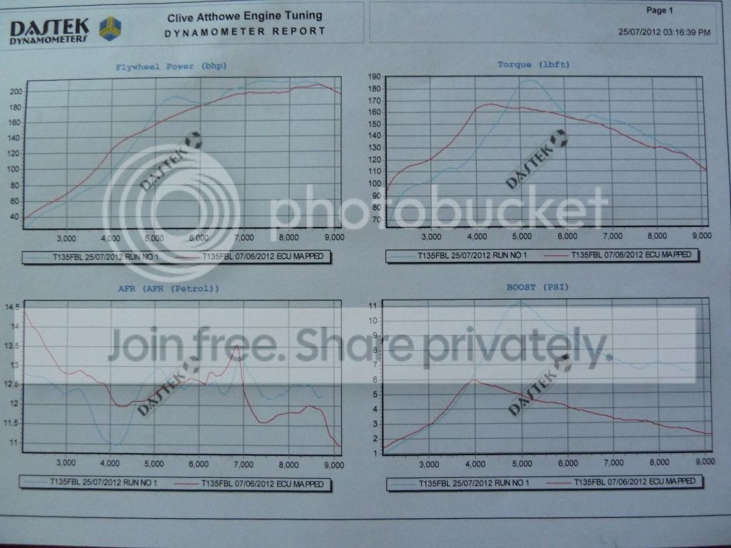

What manifold are you running ? There is a problem somewhere , you should.be making more power.on more boost , I got 360hp and 303 trq with my greddy kit ,.running 13.5 psi with e85 ,

Im using the standard cast greddy manifold and downpipe im going to look for boost leaks and try a compression test if that fails im going to change the intercooler as i think its smaller than standard

Why a compression test? You need to find out why it's not holding boost!!!!!! Also I'm using the same Greddy intercooler and I'm at 440whp so that's not your problem either! You can take my advice or not but I'm done trying to help you out.
/end rant

sorry what i meant was that the intercooler i have is smaller than the stock greddy intercooler (i only found this out after i bought the kit) some one mentioned it might be worth doing a compression test just to rule any thing with the engine. i appreciate all the help i can get

I was told to do a compression test prior going FI. Just to see if there was anything funky going on with the car itself.

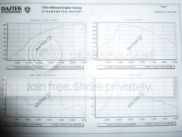

Originally Posted by nick300zx
Hi guys i fitted my Greddy kit a while back and had it mapped, first without a boost controller, i presumed the reason i was not geting any power was the lack of boost.
then i went in again with a boost controller fitted and got this
mods are
rc550 injectors
greddy kit
greddy boost sensor
jap speed exhaust 62mm
test pipe
any idea what's going on
What's up with your AFR? It's all over the place. I'd suggest a different tuner to start.
