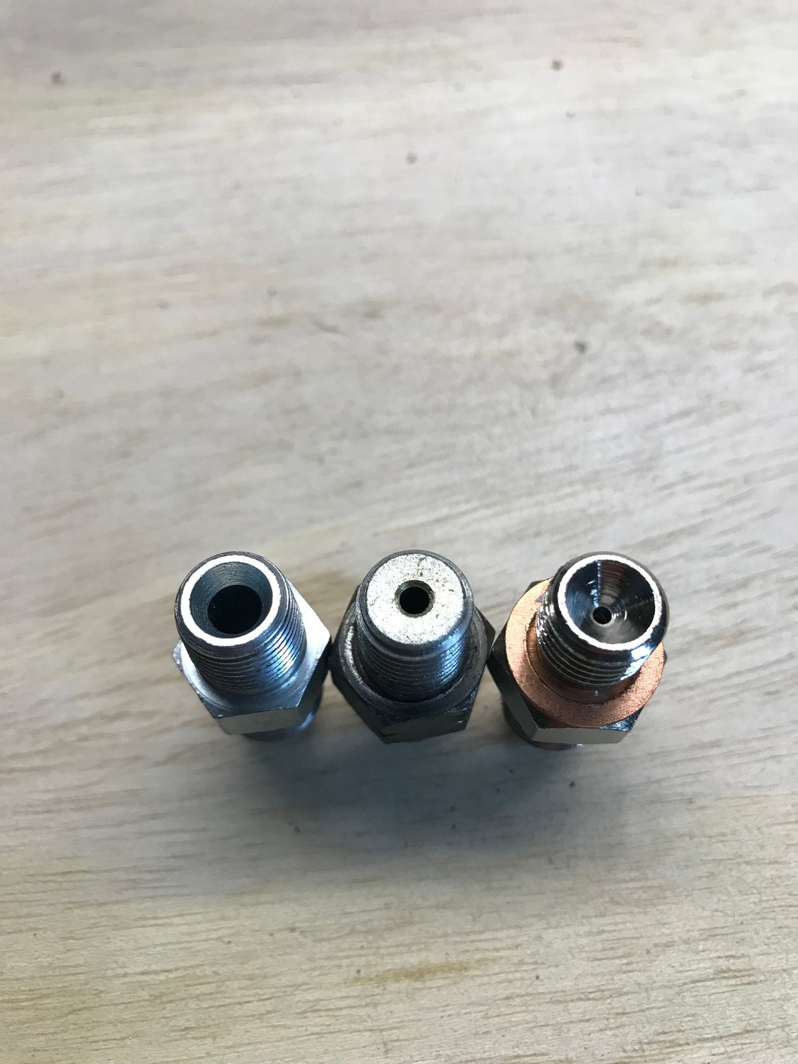

I wanted to show some different restrictor sizes real quick.

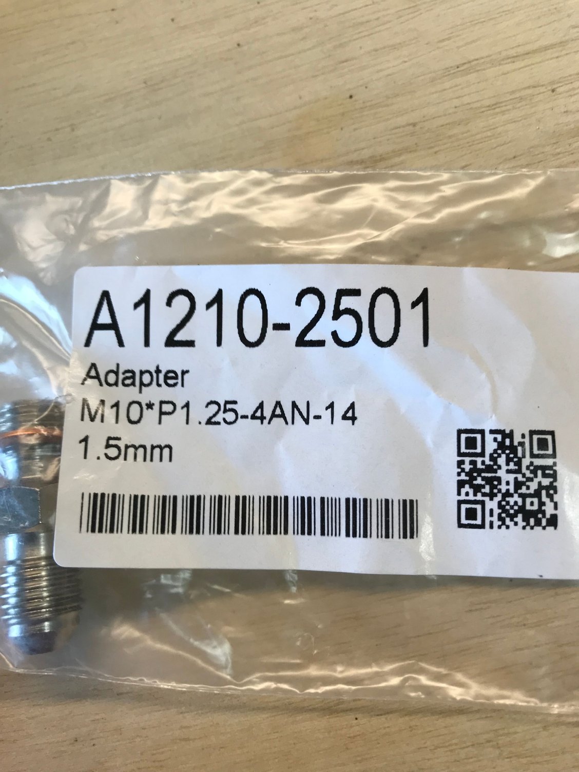

The left is a full port -4an, middle is the Greddy supplied fitting of unknown restrictor size, right is a -4an with a 1.5mm restrictor.
Greddy doesn’t know the size of their own restrictor, Mitsubishi won’t comment and a local turbo shop recommend the 1.5
Im trying to locate a -4an fitting to match the Greddy restrictor, my crude measurement shows 2mm but it could be off. I’m gonna order a handful of sizes. Every aftermarket turbo company I talk to recommends the 1.5 for the T518z, seems small even with our oil pressure.

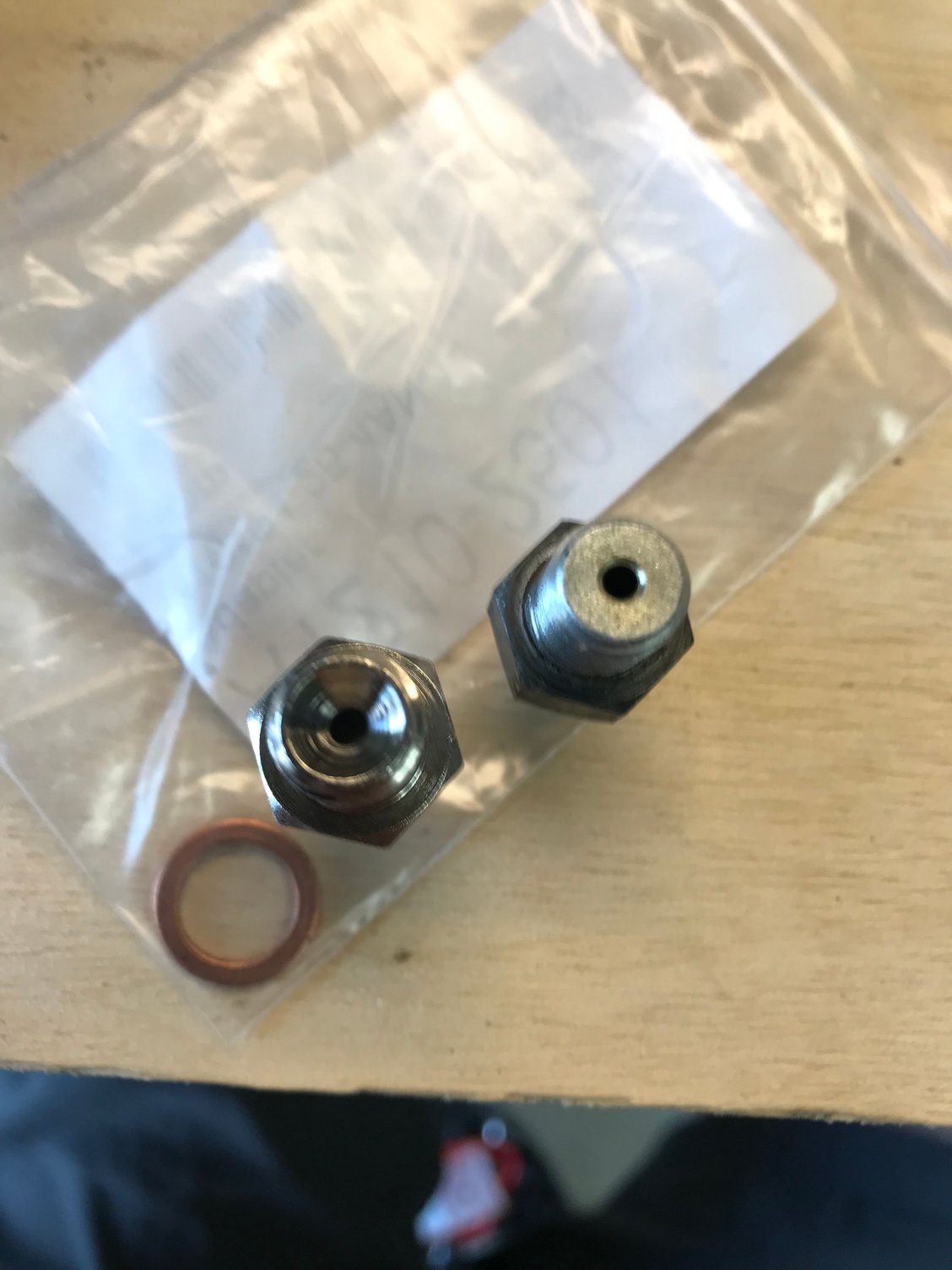

Ok after taking measurements I drilled out the -4an fitting I had from a 1.5mm to 2mm, the original Greddy size. I know it’s a small detail but I couldn’t find this info anywhere, not even Greddy. I’ve read about a handful of Greddy oil feed line failures.
Greddy fitting on the right, -4an drilled out to 2mm on the Left.
