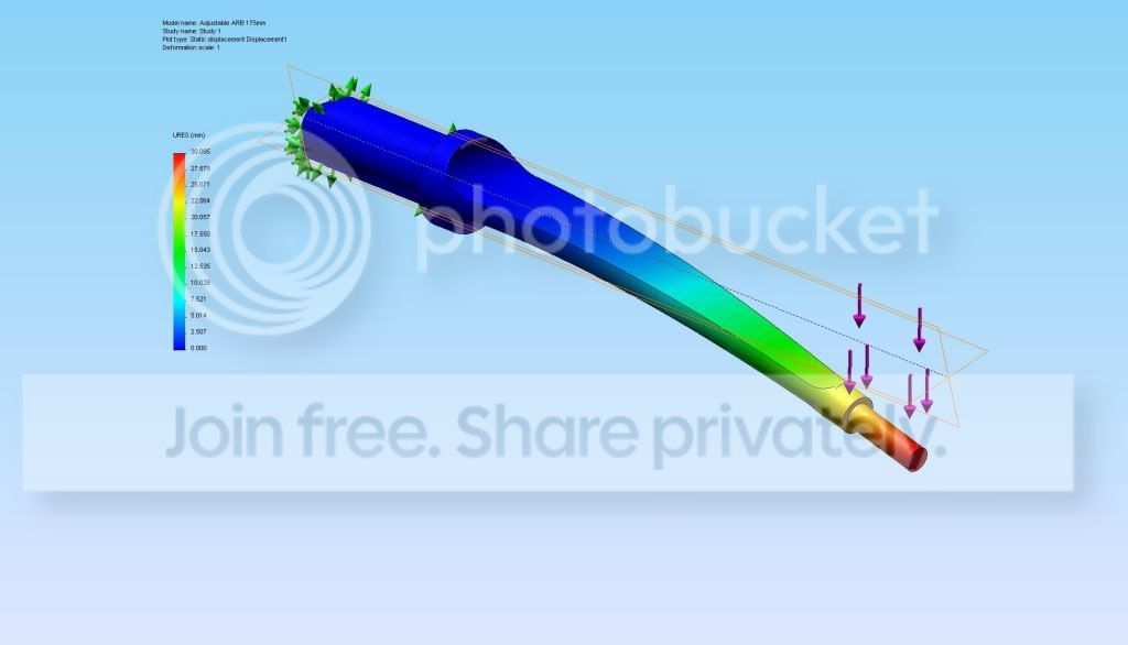

Originally Posted by Random1
I don't have experience with blade type sway bars, only have driven on one car. My guess is that there may be a blade design/selection (sizing) criteria for angle range that is optimum (not all blades are equal for all applications?). I have seen various sizes of blades available specified in size (dimensional) and force rating.
I searched for a blade angle vs force curve but could not find any. Know where to find one?
This Swedish web page shows a few selections for blades. http://sellholm.se/article_group.asp?id=29&g=6
Found these FEA images of a blade in two positions which helps get the concept across.
Flat (soft)
Vertical (stiff)
I'm pretty sure the issue is not when the blades are full stiff as they will move vertically as depicted.
When the blade is full soft, will still move vertically, but, you may have a two stage effect as the blade has to deflect a certain amount before the bar will start to twist.
The biggest issue is anytime you are at a partial setting the blade will deflect at an angle both laterally and vertically which probably explains the complaints about the feel.

I would imagine that the endlinks are not able to be positioned vertically, thus the stiffest position is when the arms are oriented in plane with the force from the endlink.
